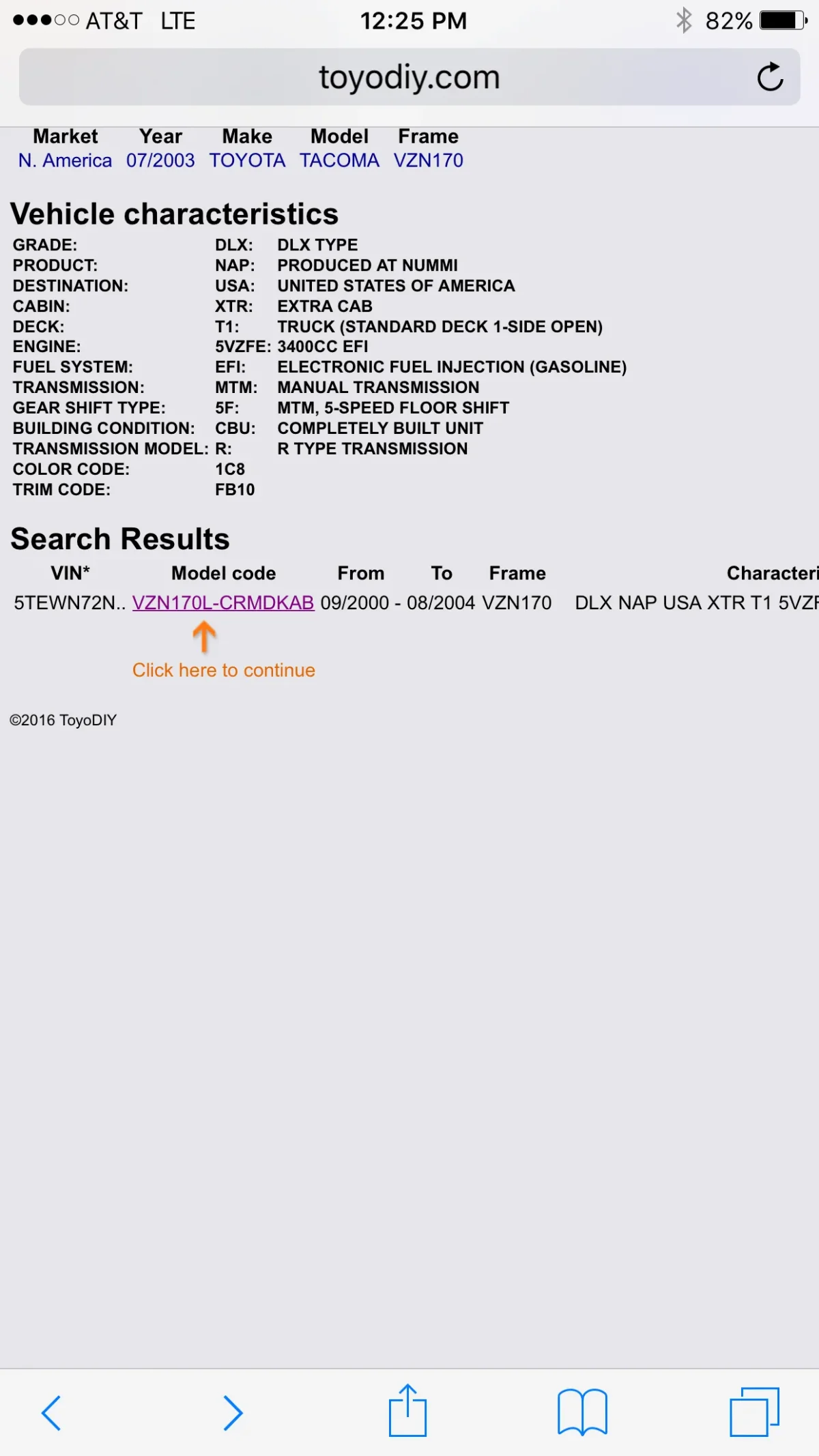

What drivetrain and engine are in your Tacoma?
I found all of the specs on the truck, maybe this will explain it! I know it has the 3.4 V6.
