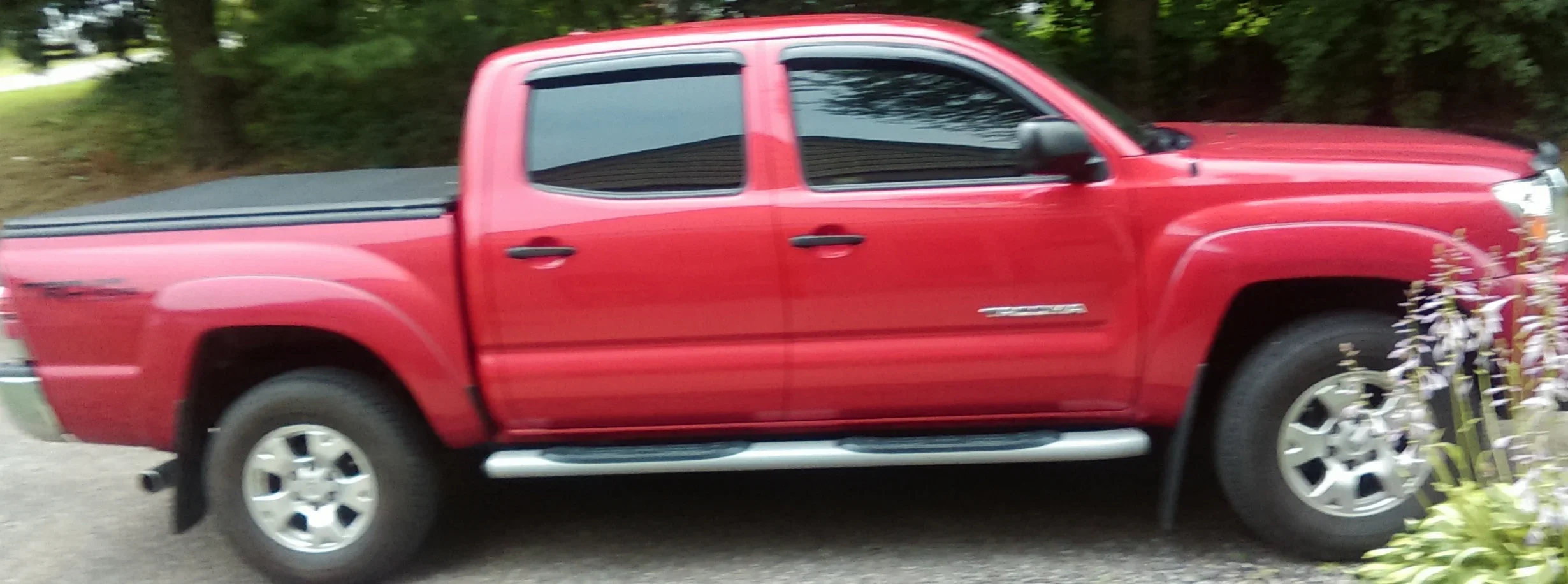

Pic of the truck?
16-18 rim will now affect the tire size enough to impact anything. I'm running 265/75/18 on my taco. However I am running a 3" suspension lift. You can run any time up to a 20" rim with only a 3" lift. You can squeeze 265's under a stock 6 lug body but you'll scrub here and there

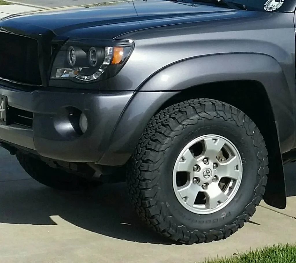

BF Goodrich All-Terrain KO2 265/75R/16 Best BFG tire, and great size for stock truck.
