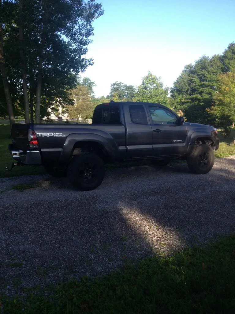

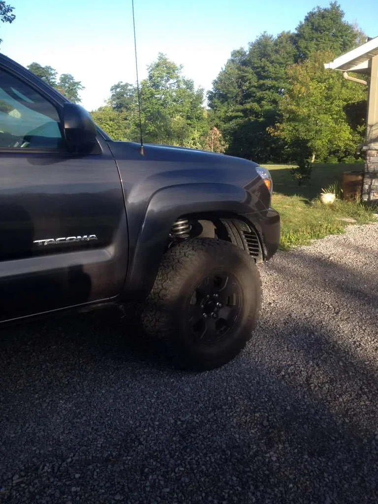

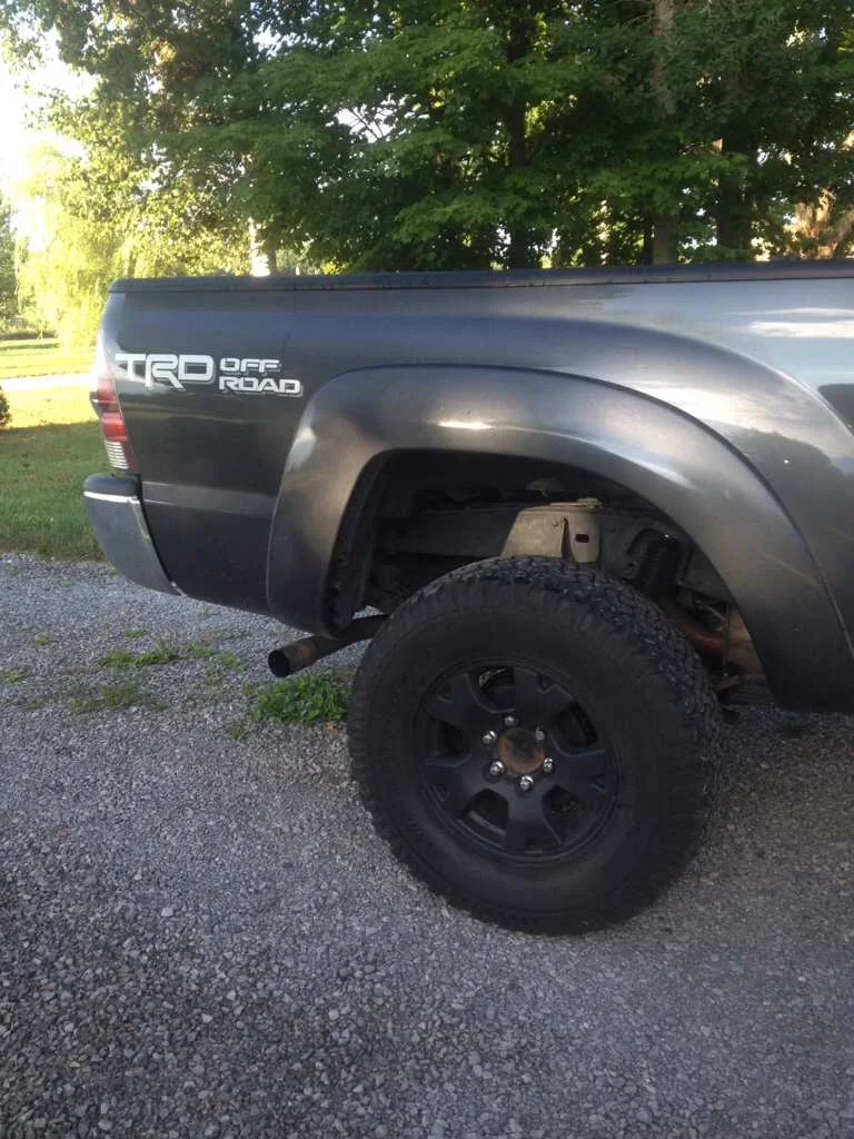

I just put the Billy 5100's in yesterday along with the Eibachs up front and the Icon progressive leaf pack in the back.
I measured before and after and achieved 2.5 inches up front and 2 in the rear. FYI I kept the overload leaf in. The truck still has a slightly higher rear end but looks badass to me.
I put 275-70-16 BFG KOs on with the stock rims. No rubbing at any point.
Big thank you to everyone on the various forums that provided great info during my research. I'll post a couple if picks soon.

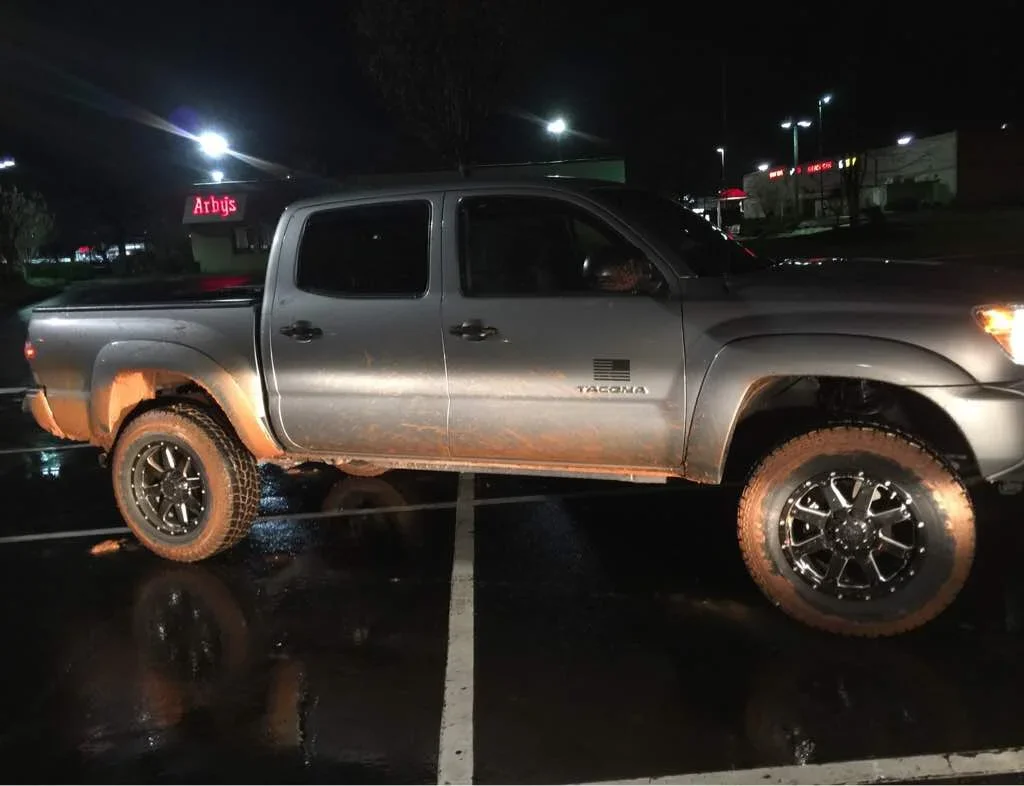

3" ready lift suspension lift 33" tires, 18x9 wheel, procomp 3" rear shocks and a hella lot of mud
