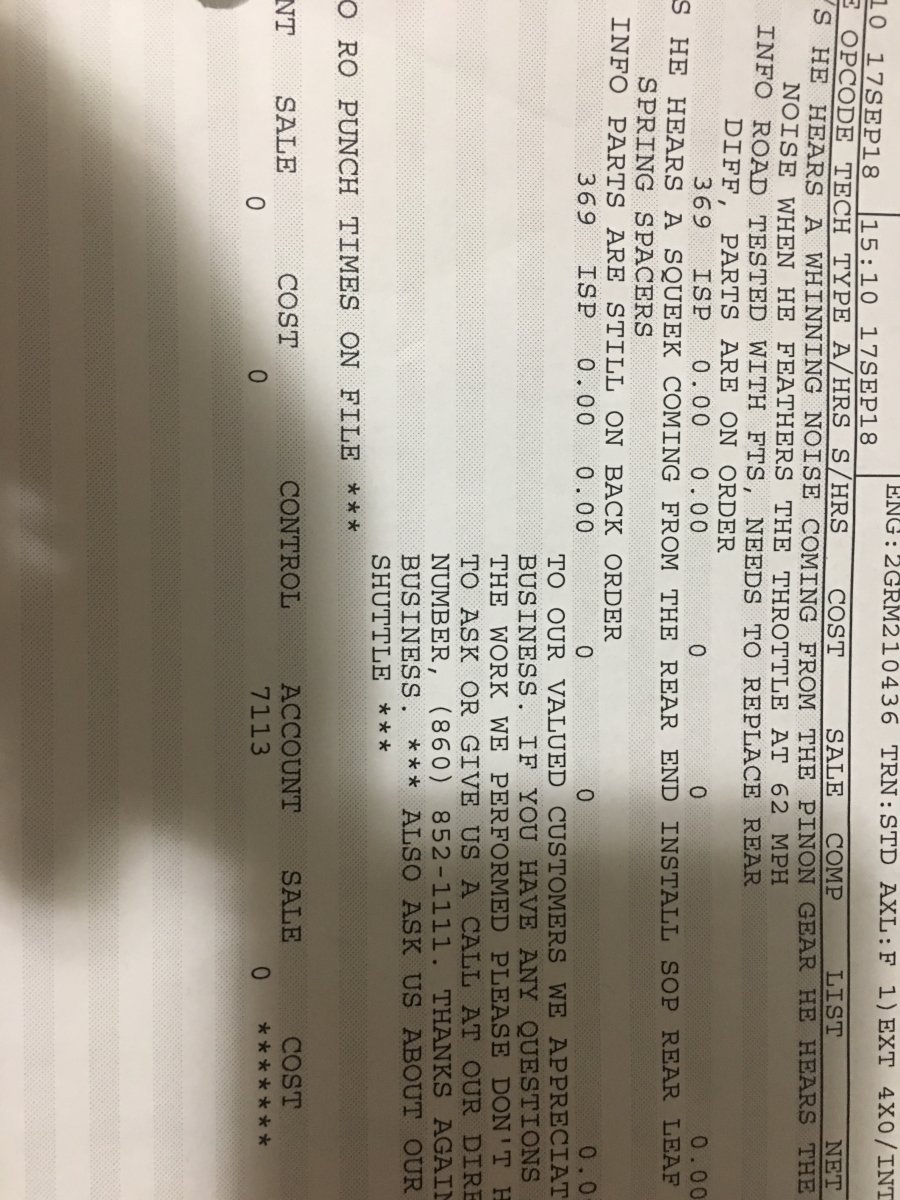

So I have had this whine for a while now and everything points to the pinion gear. My dealership told me it was a noise from the manual transmission and that it called for a sound deadener. I let them . They called and said the noice was gone. I picked it up and it was the same familiar noise still. I crawled u see and took a few pics before I called them back. Gonna go back so they can hear it. IMG_1461.jpgIMG_1462.jpg

There is a TSB for the whining rear end.
I had the whining noice since day one and finally went to my dealer. They put a bandaid on the manual transmission and noise persisted, I told them it was the rear end and it took a factory rep to test drive it. Today he drove it and they ordered the rear end. Long way to be happy. Waiting on my leaf spring bushings(back ordered till unk).
