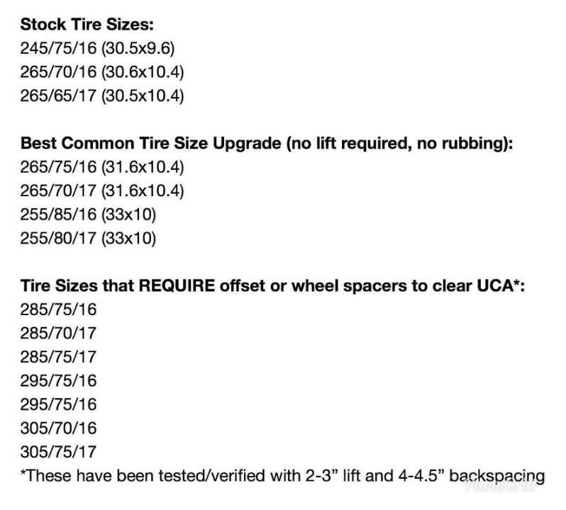

  5. OR17TRD
    Welcome to the forum. Ditch the 35’s they will be more money on mods then they are worth.
    What’s not to expensive for a lift?
    What’s your usage going to be?
    Off-road often?
    You can fit 265/70/17 without issue on those wheels.

  7. B-Man
    B-Man Well-Known Member
    Welcome to the forum!

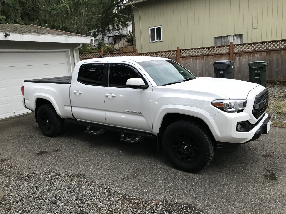

    I’m running the 265/70/17 on some 17” TRD WHEELS... (+4 offset)
    Now that I’ve driven about 800 miles on my Taco, I want to upgrade to a level or lift; may 3 inches..
    Any brand y’all would consider on the level/lift and with a 3” lift what tire size could I run without cutting and rubbing? I’m gonna keep my 17” wheels and want beefy look. Thank in advance to all who send their input!!

  10. OR17TRD
    What’s your budget on the lift? You can run 275/70/17
  11. OR17TRD
    That looks good. I like the white TRD center caps
