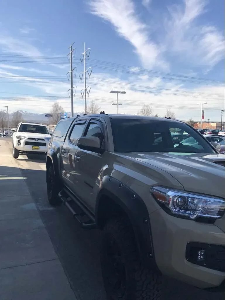

    I just say bye to my 2016 Tacoma and say hello to my 4Runner.. I got enough of the transmission problems they told me that they acknowledge the problem and truck has issues but they can't fix it... the manager offer me a good deal and is done ImageUploadedByTaco Forum1489117001.501722.jpg

    Congratulations. I love the runners.
    What list of issues did you have and how did it get to the point where they worked with you on the trade?
