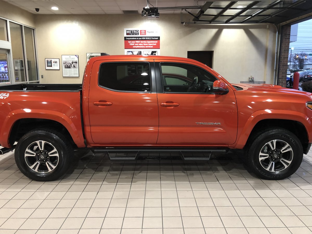

    Not very knowledgeable about lift kits , so what should I be looking to get or know about lift kits? Don’t plan to do any off road more just for looks and to be higher. Tires for this also would be helpful
    Thinking a 3 in lift? Pros / cons Thanks
