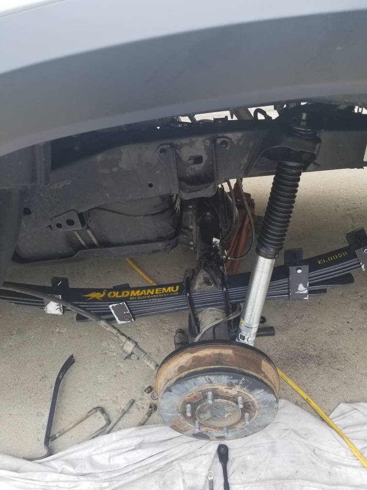

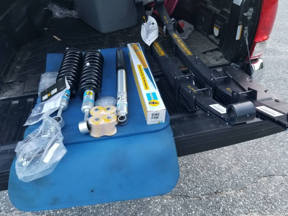

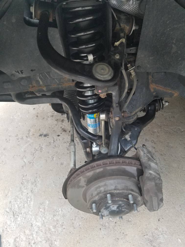

Try getting in touch with Headstrong Offroad. Tell them what you want to do and they will help. They did good by me not just trying to sell you stuff but being sure to sell you the right setup. I did a two inch with Bilstein 5100's and OME 588 springs up front and OME leafs in the back and after settling have a 2 3/4 inch lift with a better ride than I thought I would.

Yes installed with the help from my brother. I paid $1,400 for the kit through Headstrong Offroad that was front struts with springs assembled, rear shocks with OME leafs, extended brake lines carrier bearing spacer and the 1/4 spacer for the taco lean.
