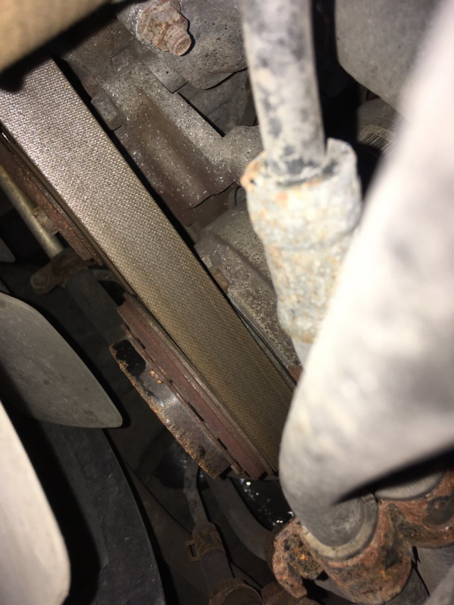

A few days ago I went to turn on my A/C and there was a squealing, screeching noise for a few seconds, then it stopped and the little indicator light on the A/C button started flashing, then the screeching stopped. Fan is blowing air just fine, but it's not cold at all.
Any ideas for trouble shooting and repair?

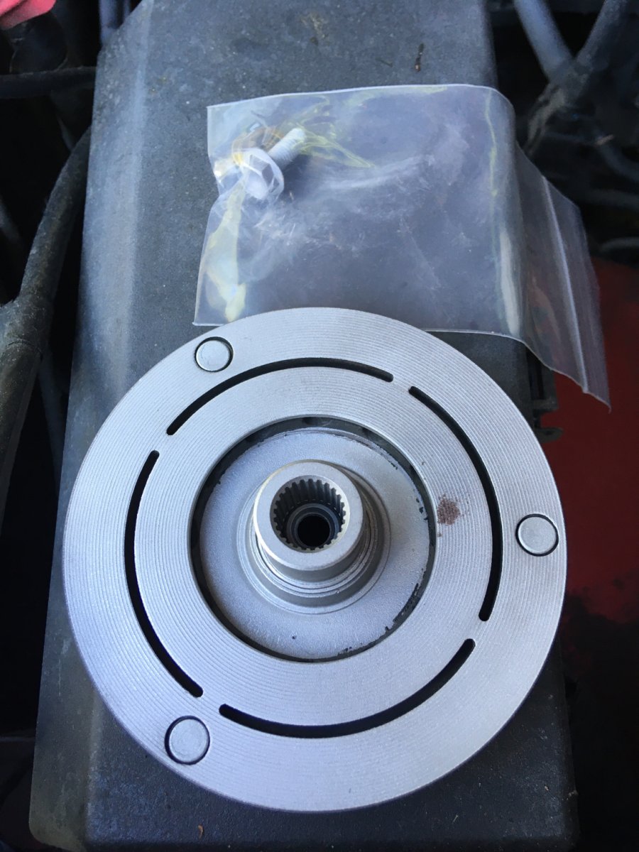

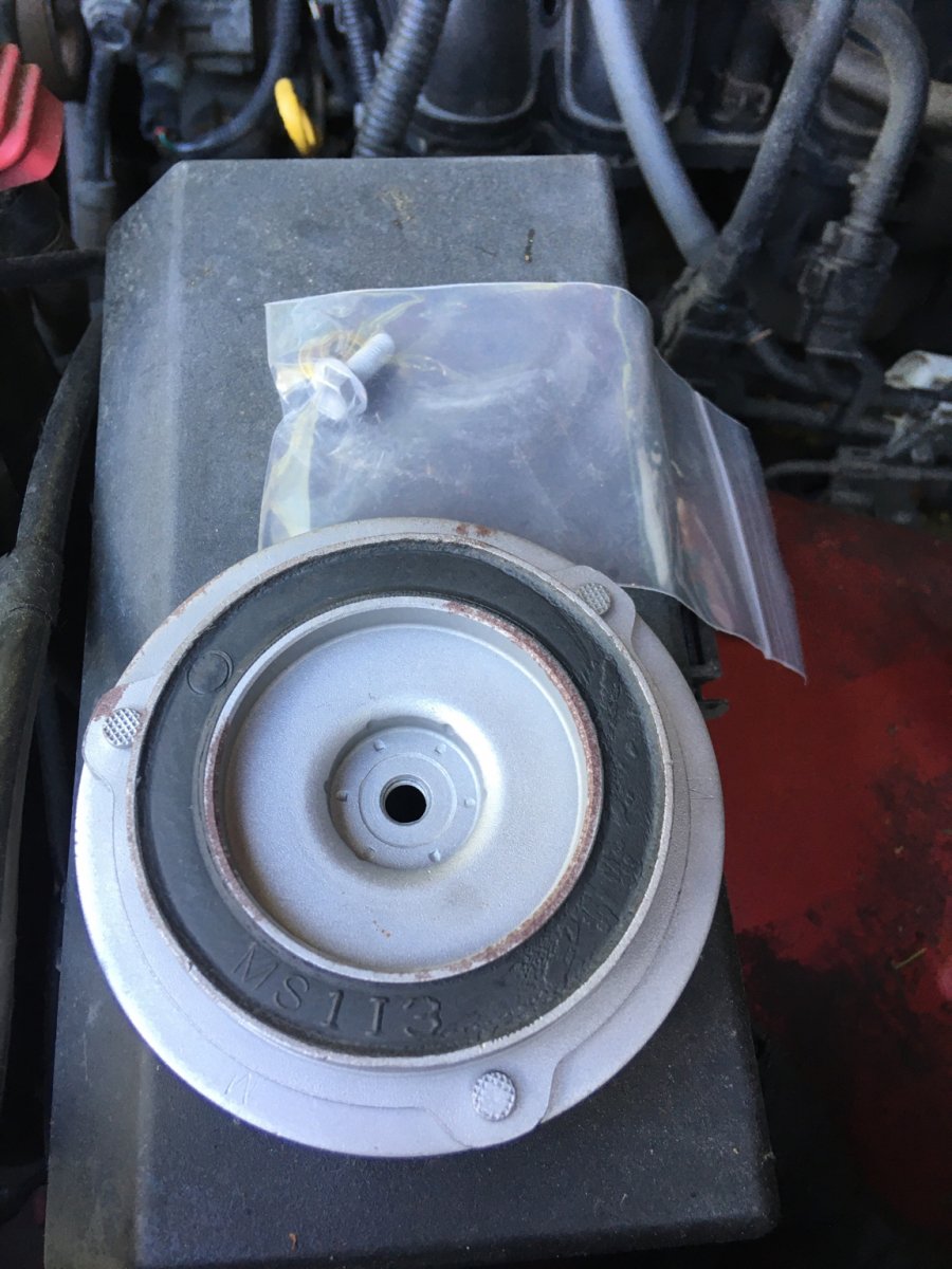

It is usually only the clutch on the compressor! 25$ on eBay and about one hour easy job if you are handy. Full of video on the web ! I already changed 2 on my 2013 2.7l Tacoma [emoji106]
