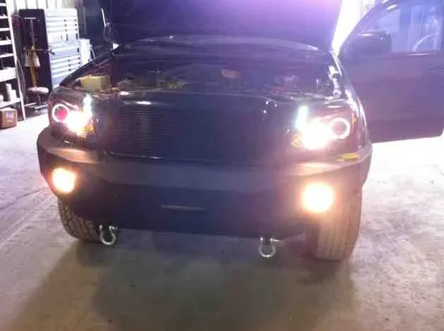

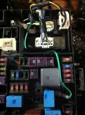

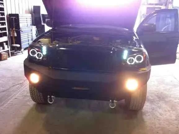

Just did it in about 5min. Easy as hell ImageUploadedByTaco Forum1376758758.560778.jpgwiring ImageUploadedByTaco Forum1376758782.461476.jpgfogs onlyImageUploadedByTaco Forum1376758806.845596.jpgparking and fogs

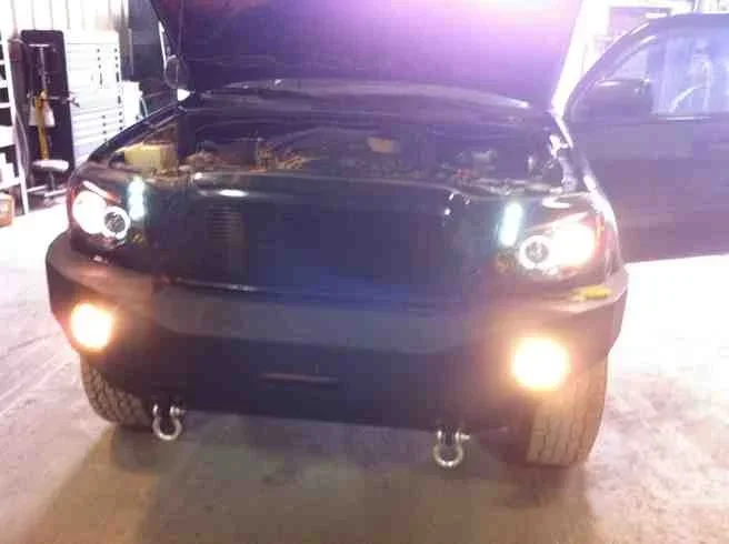

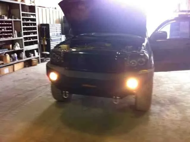

ImageUploadedByTaco Forum1376758833.742242.jpglows and fogs ImageUploadedByTaco Forum1376758869.508207.jpghighs and fogs
Those lights look like spyders. And yep that's the fog anytime mod. Done it myself like my 1st mod.
