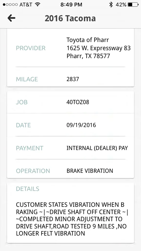

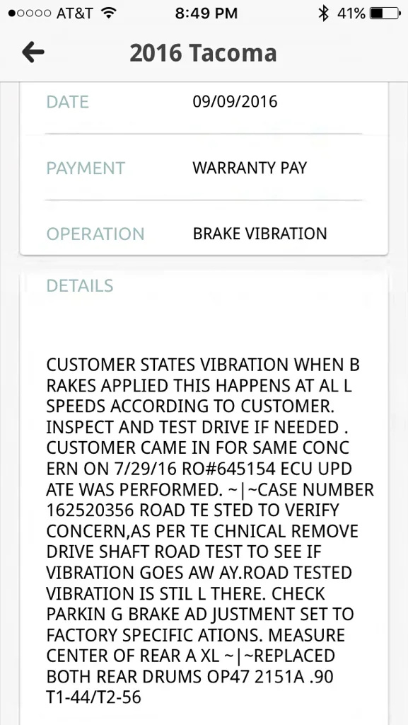

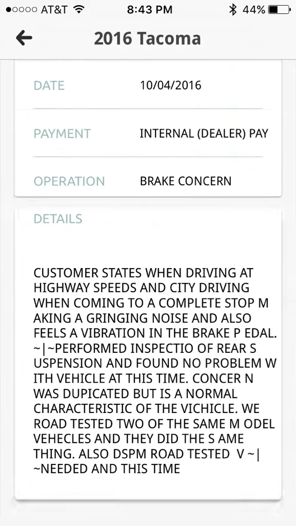

This isn't a major concern, but my new 2016 Tacoma TRD OR DC has a bit of brake vibration when braking between 20 mph and a full stop. It feels like it's coming from the front brakes. I'm taking my truck to the dealer on Monday to have rust protection applied, and while it's there I'm going to have them look at the brakes. Before I do that, though, I was wondering if anybody on this forum has experience with this issue on 2016's? I've noticed this vibration since day one, and my truck only has about two hundred miles on it now. It hasn't stopped me from loving my truck, and I can live with the issue if there isn't a fix, but I would like to get some ideas as to what could be the cause.
