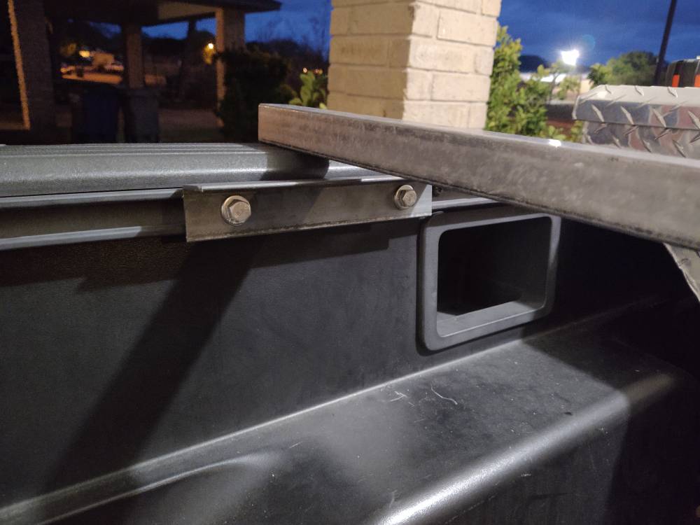

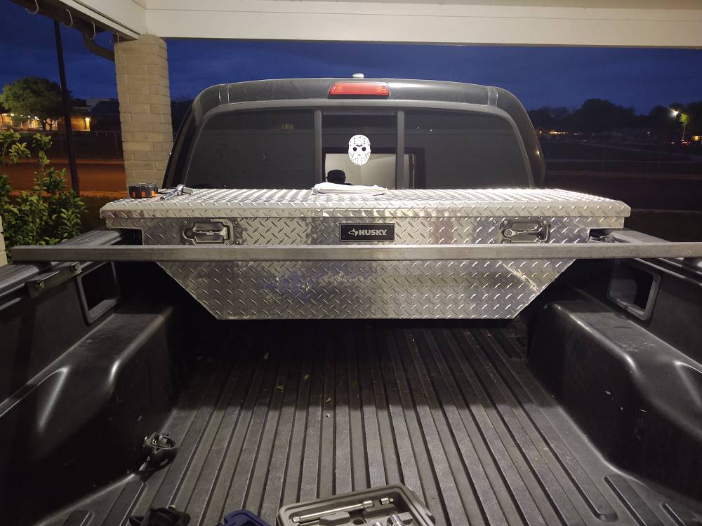

This is the beginning of my plan. It has somewhat been altered in the process of making some of the pieces.
I'm using some 3/8 16 T-slot nuts that fit quite well in the track. 3/8 x 1" bolts on 3 washers per bolt. They are holding up a 9" piece of 1-1/2" angled steel bar. Then I'm going to bolt a 1-1/4" square steel bar to the angled piece. But I'm going to have the square bar sitting on top of side of the bed. Just so the weight of us (girlfriend, dog and I) don't put too much strain on track when we are sleeping in the tent.
Once I get all of the steel cut, drilled and weather treated. I will get some wood to make a platform that we can put the tent on. I'm hoping the steel bars and toolbox will hold the weight of us.
