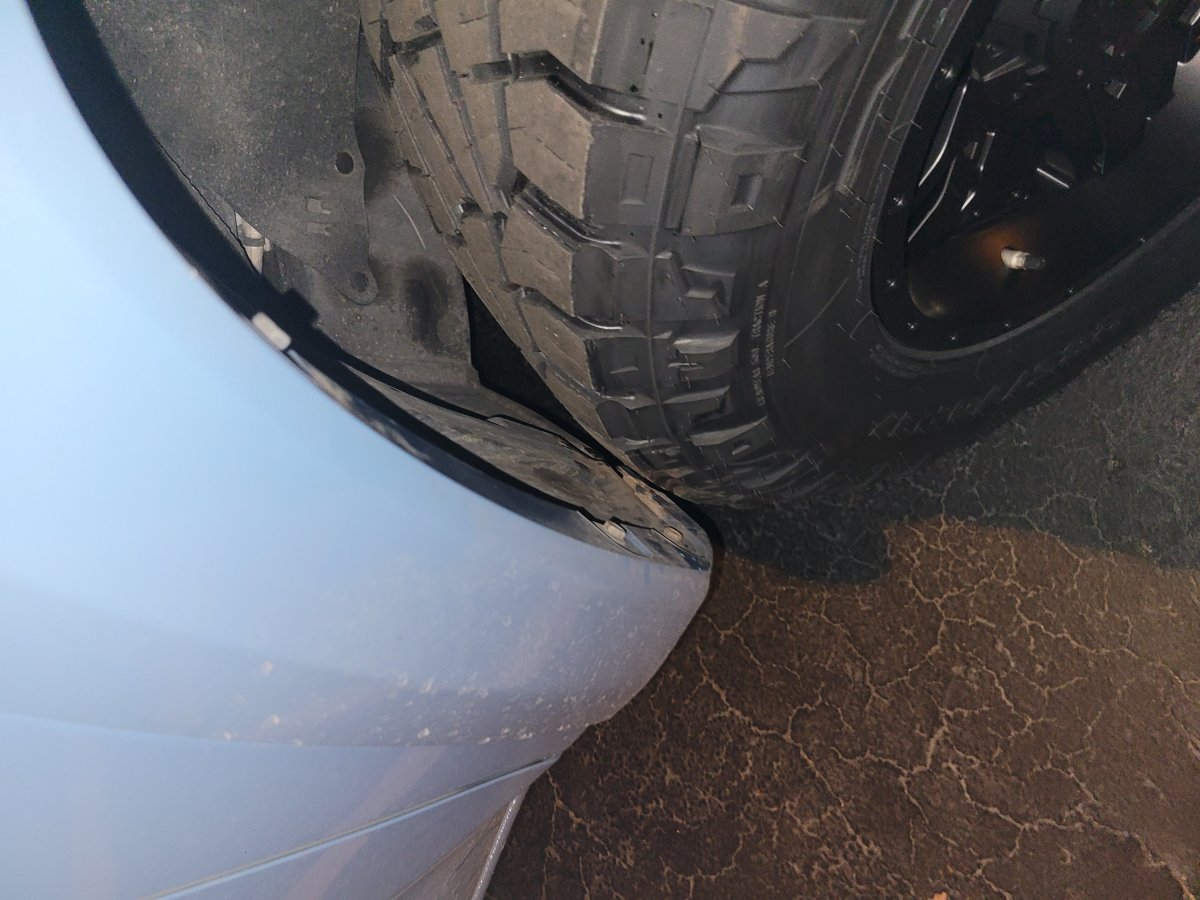

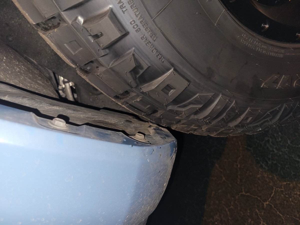

Hello,
I have a 2019 Tacoma TRD Sport. I just lifted it 3 inch front and 2 inch rear. Wheels -- 17X9 -12 offset. Tires 285/70R17. Stock UCA.
I did the alignment, but I think they didn't do it right. I'm rubbing the cab mount/fender flare a bit hard on the front passenger side only. I rubbed same part on the driver side but slightly.
I'm sending it back to alignment but I am not sure what specs should I tell the person.
Please advise. Pictures attached too.
Your wheel offset is pretty low. Anything less than -6 is going to rub more. 0 is probably the best offset for these trucks with the 2.5-3” lift and 285 tires.
You can always heat the plastic where it’s rubbing and mold it out of the way.
Do you have your alignment numbers?
