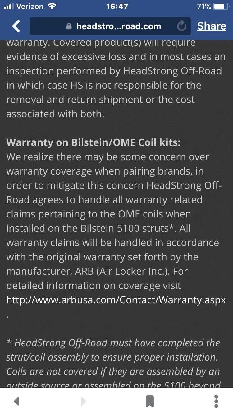

Keep in mind, mixing OME and Bilstein voids both of their warranties. Both manufacturers specifically state they are not intended to be used together. If you plan to use them together and want to have a warranty, they have to be purchased together and assembled by the vendor and the vendor has to state they replace the lost warranty themselves.
If you don’t care about a warranty... well then... whatever. But this is a public forum. And if you use them together, you’ve given the manufacturer all the information they need to deny a warranty claim.
This is one of the vendors from a Tacoma FB page that states they cover the lost warranty.
