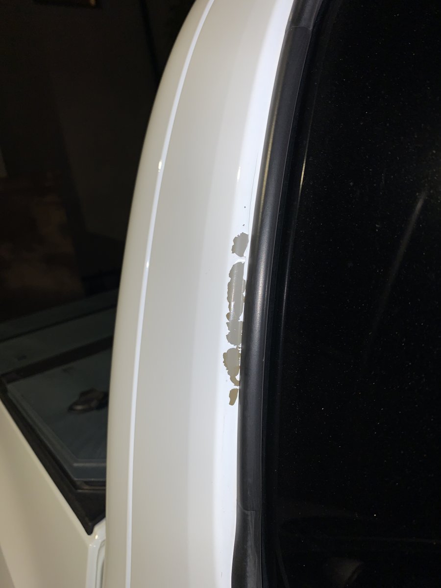

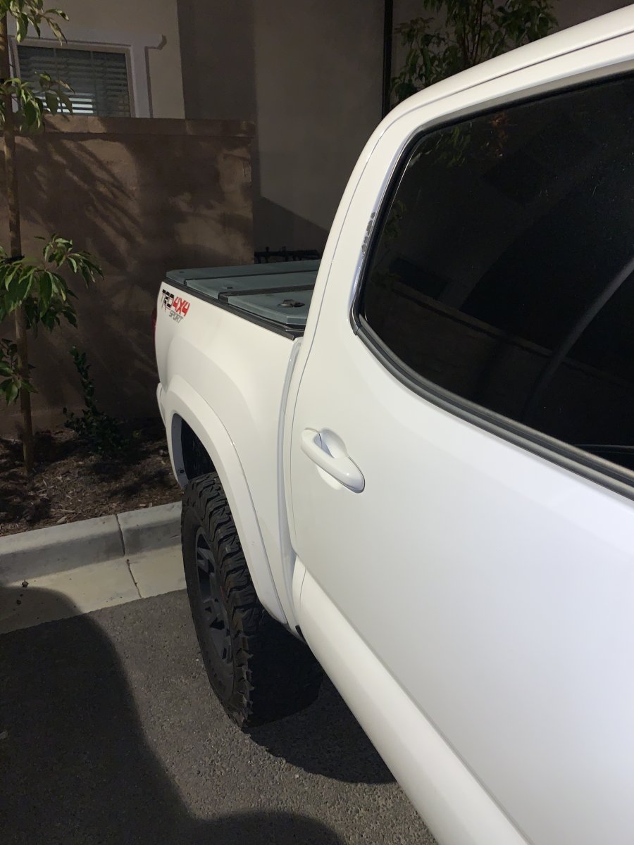

Anyone else paint chipping off on there 2017 white Tacoma? Mine is chipping on both rear doors.Toyota said it’s a known problem and they are trying to get it approved to get it fixed..... could take up to a YEAR to get approvedIMG_1577768991.830157.jpg! IMG_1577768925.728522.jpgIMG_1577768953.651700.jpg
I have not noticed this on my silver 2017 Tacoma SR5. Maybe just an issue with white paint or just a few trucks?
it has a 5yr warranty on the paint (something liker that) so they have to fix it
Know issue on white trucks and always the same location. Don’t remember what caused it but people are reporting that Toyota is fixing them.

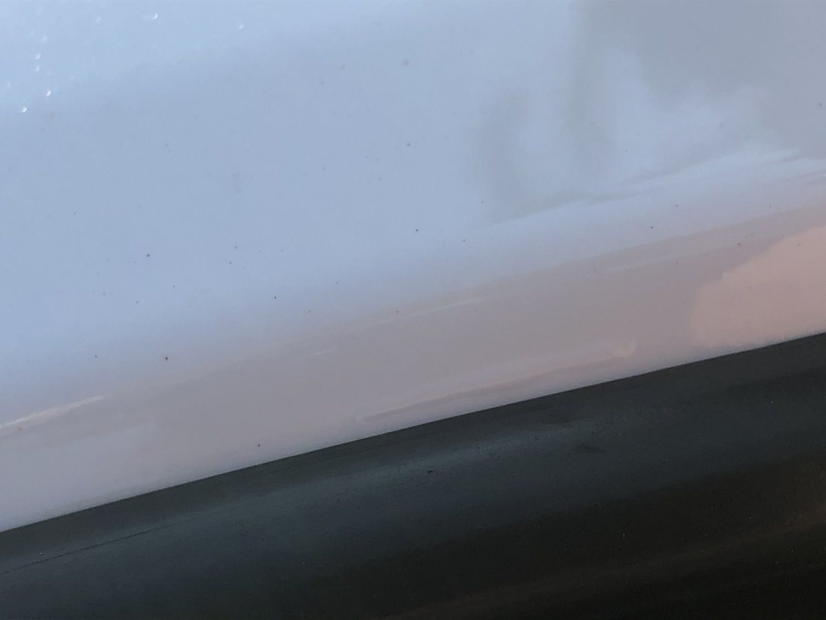

I just saw your post. I had this issue a little over a year ago. I have the 2017 White Tacoma as well and the paint chipping is in the same spot as yours. I had it fixed by Toyota. About a week ago I noticed the paint bubbling in that same area again. I checked but I just don’t see any water issues that may be causing this.

White is always notorious for peeling. From my experience, white paints tend to be thinner than other colors. And its peeling there by the doors because the paint is thinner on all surfaces that arent parallel to the overall body lines. The paint guns dont adjust to the angles and edges, allowing less paint and clear coat buildup in those areas. Also, could be a reaction between the sealer and white paint.
If it bubbled up before and after they repaired it, I'd bet it was a chemical reaction from the E-primer and sealer.
I think its’s bonding issue which is why it seems to be flaking off. The first time around for me that’s what was happening. I just think it’s weird that this second time around it’s bubbling up in the same area after it was repainted over a year ago which made me think there was maybe a pin hole size opening where maybe water was getting in but I didn’t seem to see anything like that after I checked.
The paint is definitely thin, I think my paint was at about 2.5-3 mils.
Yea. It should be 5-7 mils thick. The bubbling also could be where the body shop rushed the job, and didn't let the primer or sealant cure before putting color down. Solvent gas has to go somewhere. Either way, it should be under warranty from the shop, depending on how long been.
