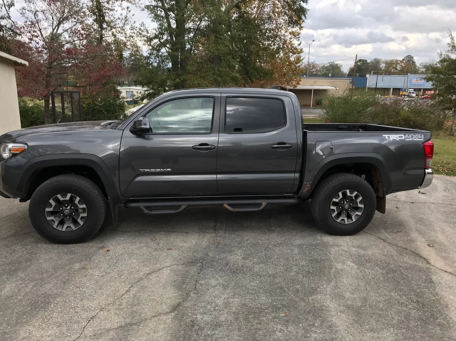

This mod is well worth the time to do it. The factory speakers are cheap... cheap.... cheap! I followed the instructions and parts lists found on this site and it was a breeze.
Sounds awesome... went with the kicker tweeters from Subaru and kicker 6x9 in front and kicker 6.5 in the rear. Easy install took about 2 hrs for all 6 speakers.
Sounds soooo much better!
