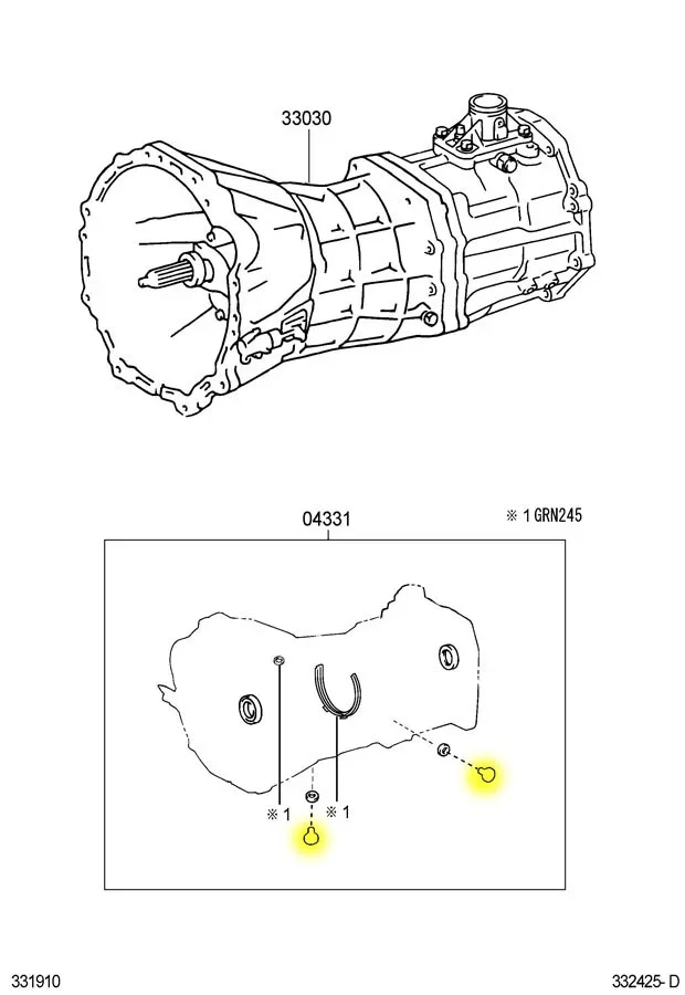

Thanks. What I'm trying to get at is this. Is the transfer case and the manual transmission the same thing? If not where is the spot where I change the manual transmission fluid. It's a 2010 Tacoma 4 cylinder by the way.
Ah, same gear oil different drain and fill plugs. I take it you have the 5 spd. The fill & drain plugs are highlighted for your tranny. The transfer case fill & drain plugs are not hard to miss they face the rear of your truck and are 24MM bolts. One hi, one low, you can use 15/16 socket as well.

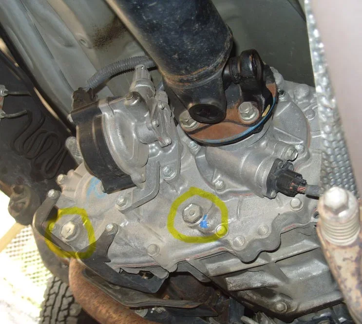

Here's a pic of the transfer case fill & drain plugs, I circled them in yellow.
