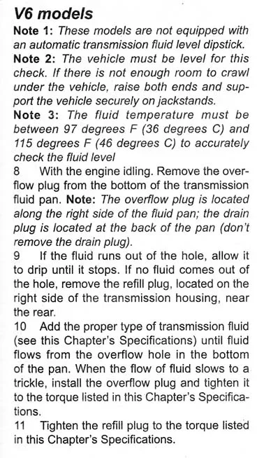

Measure how much you drained out and replace at least that much. An '08 should be drained and filled every 30k according to the manual.
You didn't mention what speed transmission so.......
4-speed Auto = Toyota Genuine ATF Type T-IV fluid
2008 & earlier 2.1 quarts
2009 & after 2.9 quarts
5 speed Auto = Toyota Genuine ATF WS fluid
3.2 quarts
Refill:

Haven't had to change my tranny fluid yet, but I think my time is coming up. I've got 48,000mi on my truck and Im going to take it on a week long road trip coming up.
Im debating whether or not to wait till after the trip to change it, or before. I'm going to change the oil before the trip, but im a little cautious about the tranny fluid. I fried my tranny in my S10 a year ago changing the tranny fluid and replacing the filter improperly, so I dont want to make the same mistake. So I might just take it to Toyota and have them do it.
If I just change the fluid (draining then filling up at the overflow plug) would that suffice as a proper fluid change?

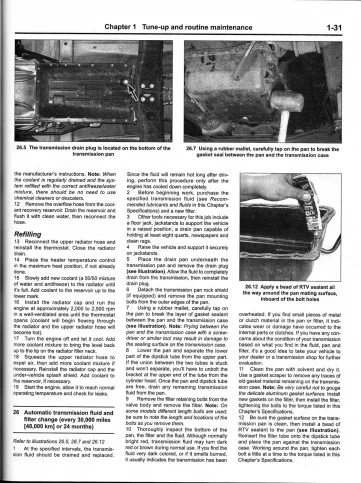

Proper fluid change requires dropping the pan and changing the filter. Doesn't do any good to just change the fluid. The filter will still have all the grime & gunk. It would be like changing your engine oil but not the oil filter.
:blink: meh, I must have a faulty manual then, it calls it a filter.

When you look at the WIX filters website they list filters. Since I have been surfing the forums many people have said there is no filter. I have never dropped the tranny pan.
I understand why some call it a screen since that's basically what it is, a fine mesh screen. I'm guessing, they are thinking filters are only the paper kind. I don't have a filter since I have a manual transmission. But, this is what they look like.
The Tacoma '05~10 V6 5-speed uses HCT 1319. Not sure if they fit the '11~13.
With screen style filters you can rinse them out with solvent or mineral spirits whatever you call it make sure its dried all the way you're good to go no need to buy new
