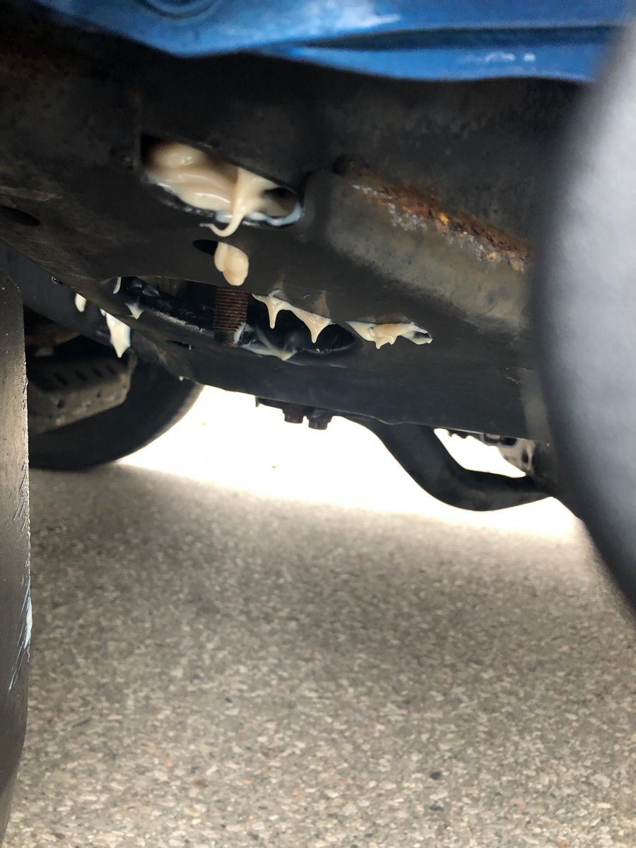

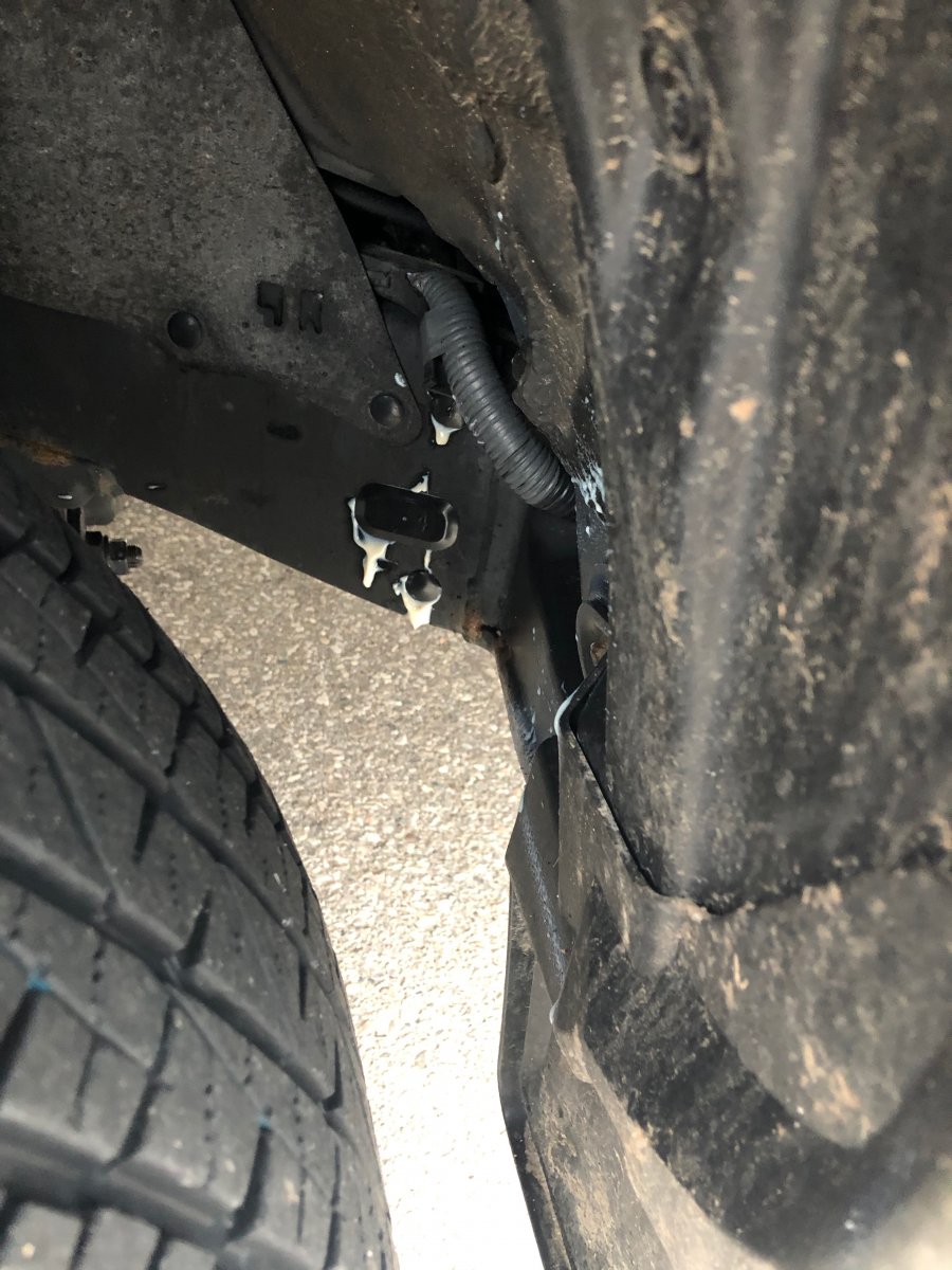

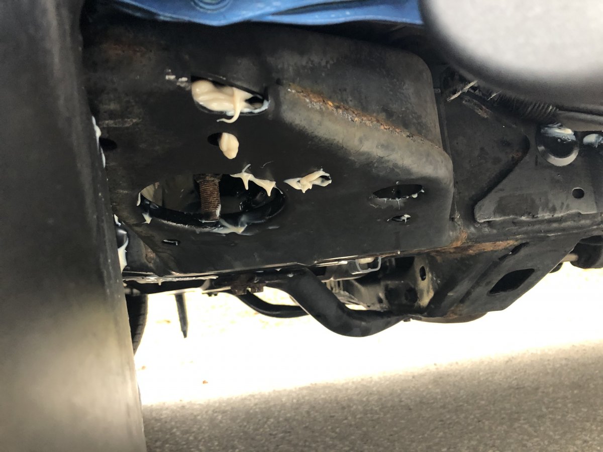

Good Video, here is what mine looked like after it came back from the dealer.
