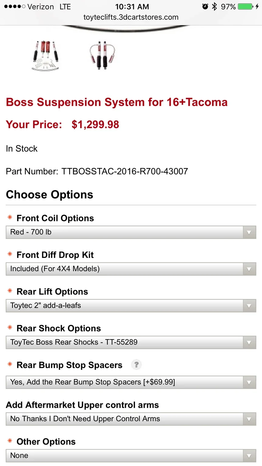

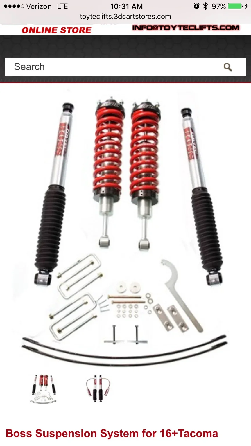

    Alright so I changed my mind a bit. I bought this lift and I'm planning on doing the 265/75/16 KO2's. They say they only go up to 2" lift. Would the 285's fit with some slight shaving in case I change my mind after? IMG_0543.jpg IMG_0542.jpg

  16. OR17TRD
    Yeah you could fit them with that set up.
