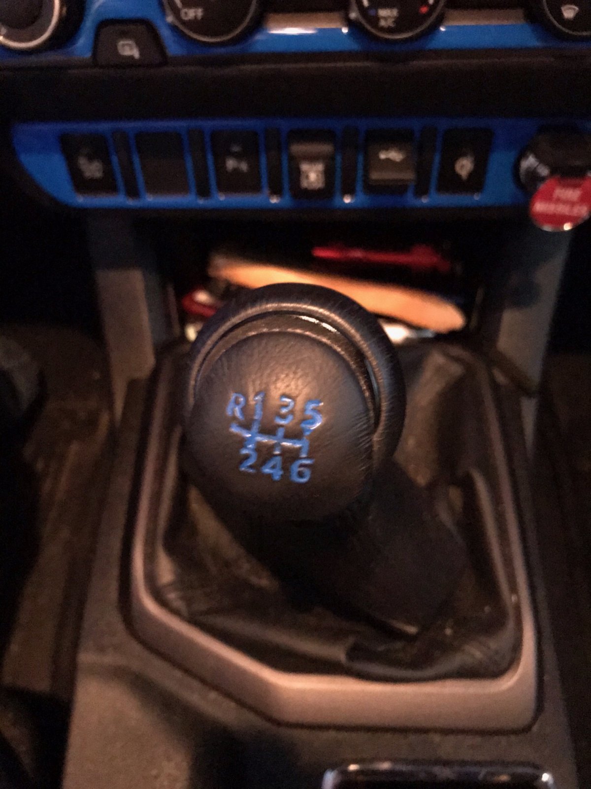

Congratulations on your 2023 V6 4x4 Taco 6spd manual. You're going to love it. And welcome to the forum. You are going to find a lot of good and knowledgable people on this here website. We love pictures of newly purchased Tacos ! By the way, have you named your Tacoma yet ?
