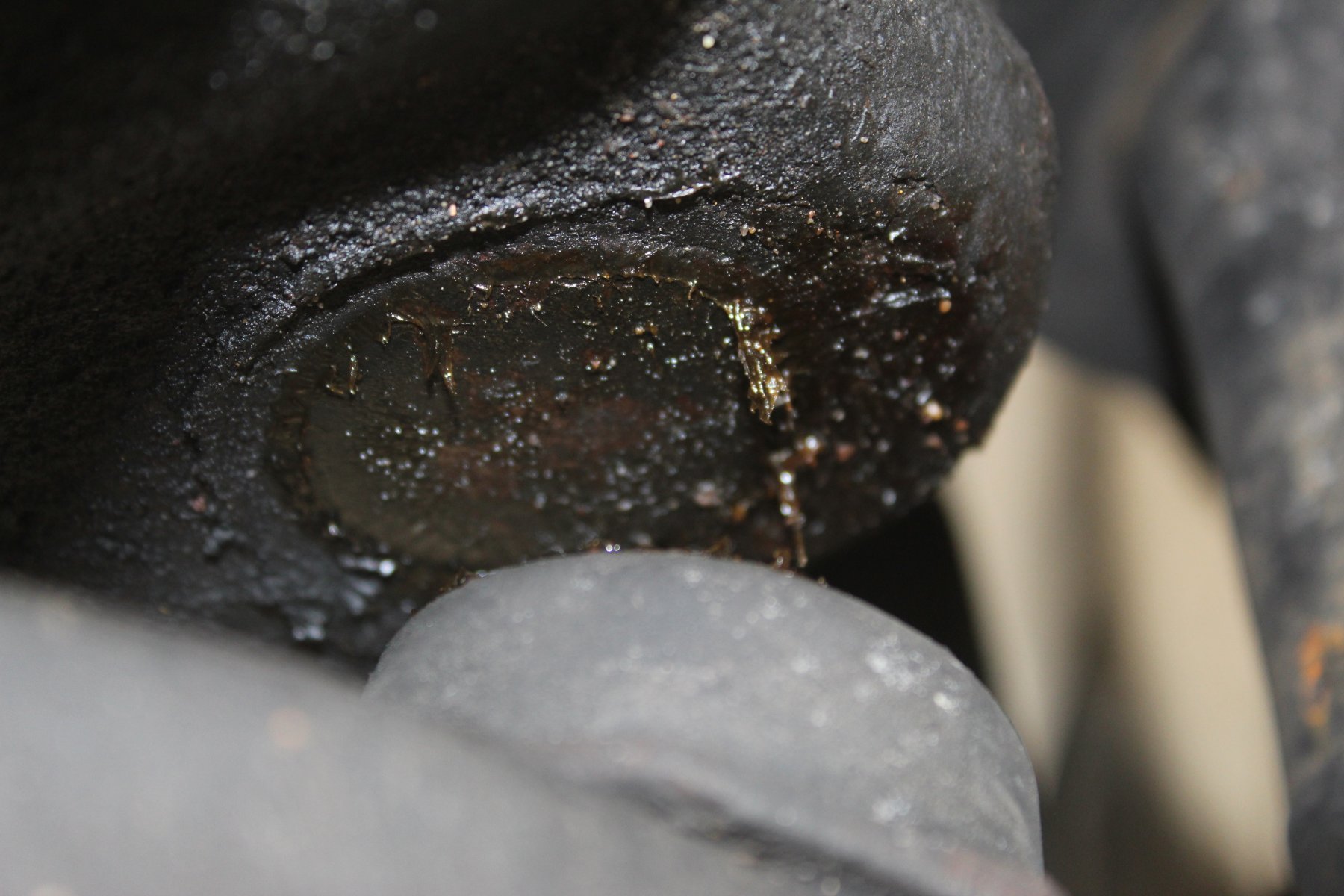

bump stops... is this the source of the bang bang banging... is it normal or no??
JayQQ97
MW surVivor ... clutched. 346k on the 0D0

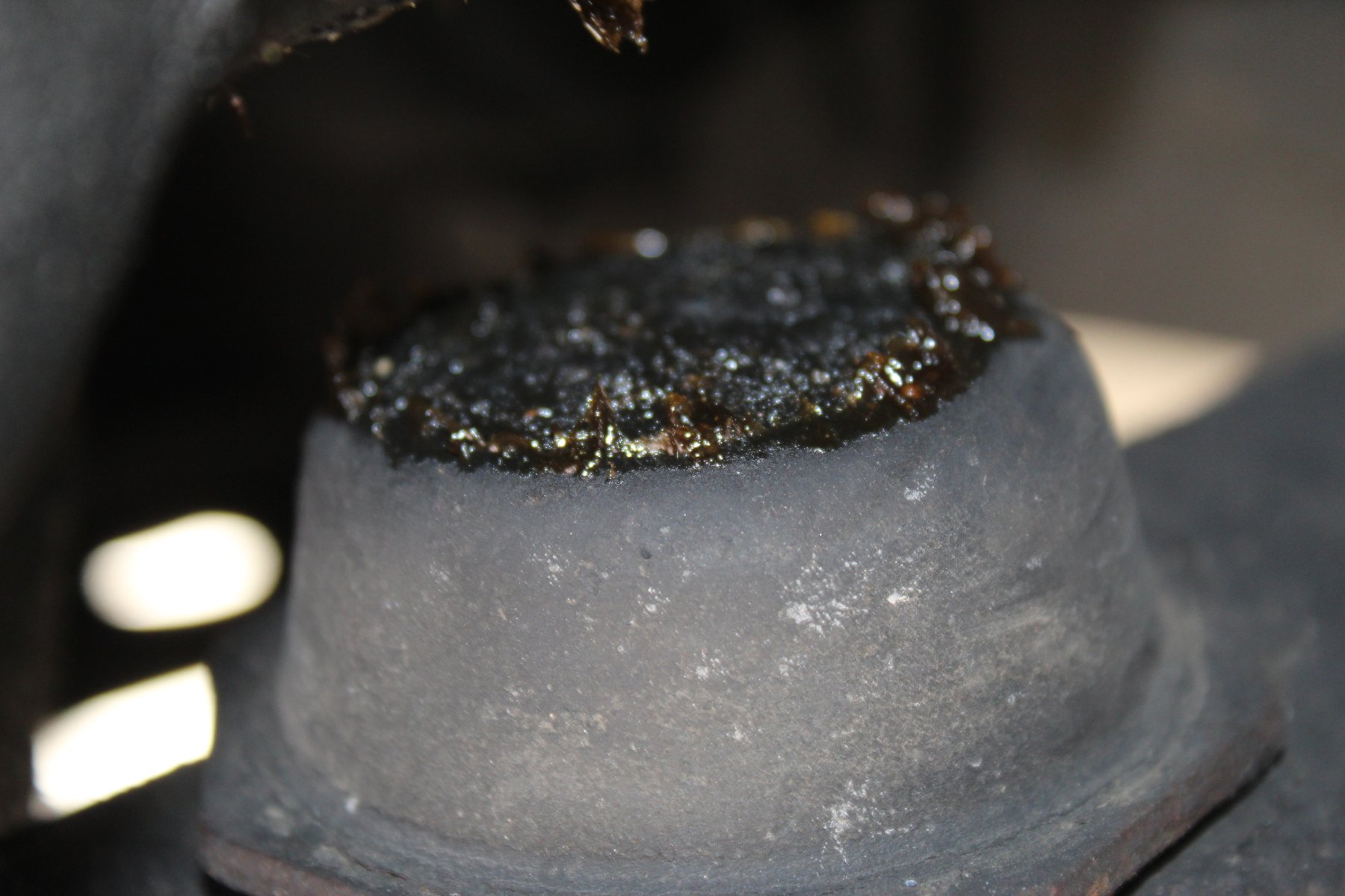

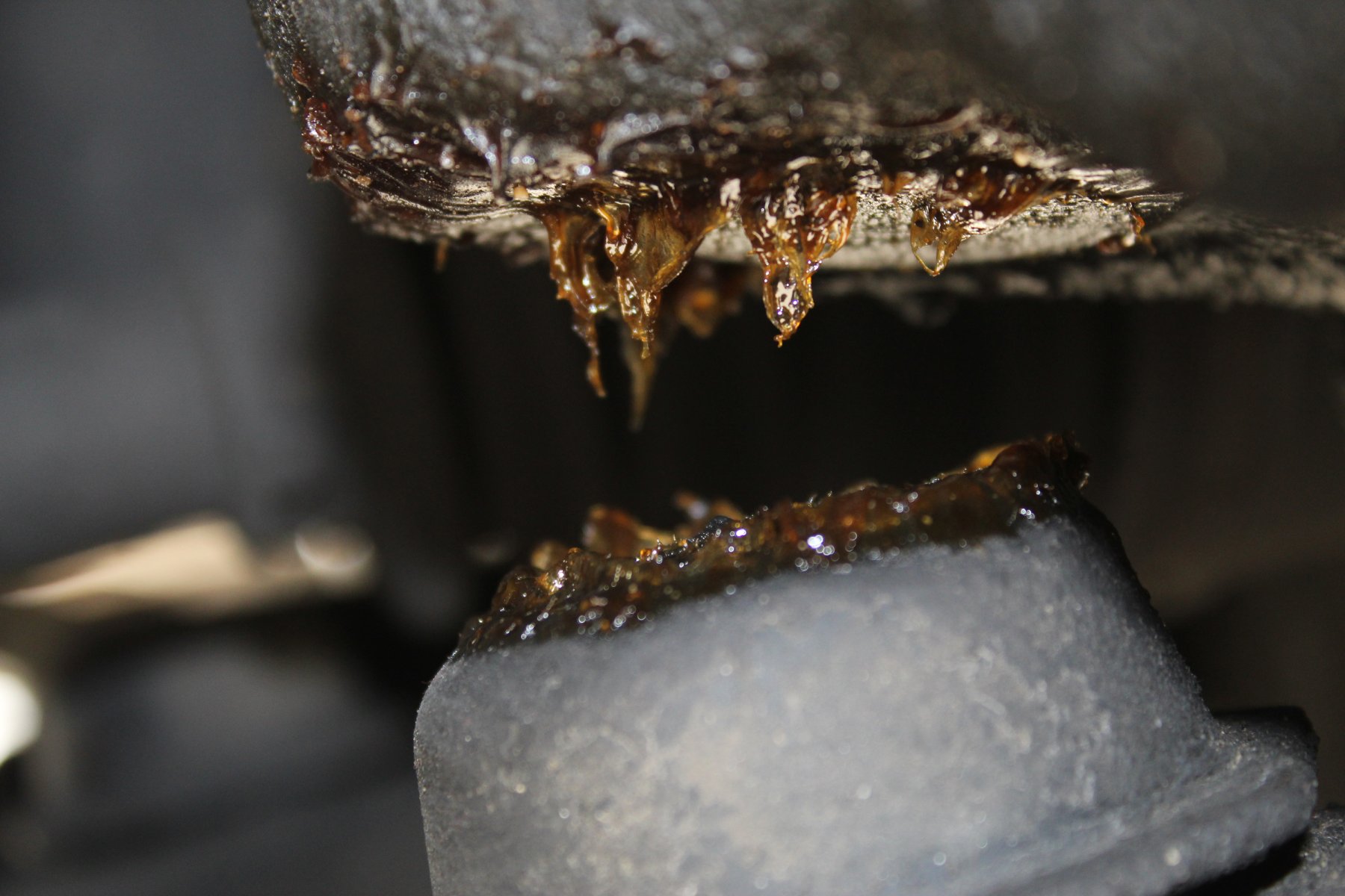

i did some experimenting to see how much contact the front bump stops on the LCAs make with the frame whatever section up front there
it looks like major contacting going on from the HV woolWax they pulled off
Bump stops should rarely make contact. No, regular contact is NOT normal.
This indicates a problem with the suspension. weak spring, dead shock, ball joints, dead bushings......

For reference when I applied the HV WW wax for testing I only put a good finger coating on the frame section and the hard round stops on the LCA were dry as a bone covered by a rag upon application

Actually there are 2 bump stops on each front LCA
This pic is the large round one closest to the front
I haven't managed to reach at the smaller one around the backside
Those are probably banging the frame as well :oops:
