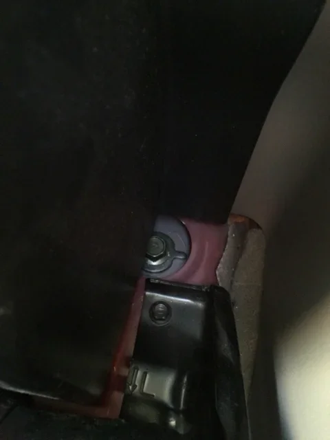

Well I didn't know their was a tac weld but attached to this and now it's broke and will not come out. So I decided to run it through the fire wall but now my cable is too short. So I ordered another one but now another problem! My cable and antenna are different and don't match up. If you could check my other post and help me out that would be great!!
Don't know how a rubber plug could be tack welded. Are you sure you weren't trying to pull out the wrong thing?
I have no idea what that's a picture of. You asked about drilling a hole in the rear of the cab and I suggested you simply pull one of the rubber plugs from the lower back of the cab. Nothing to unbolt.

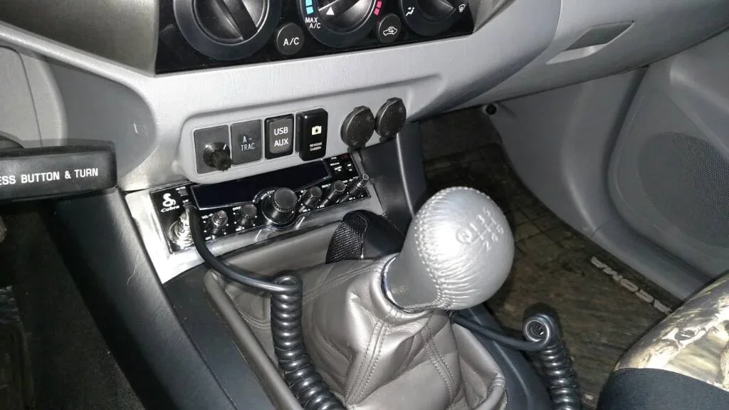

My cb will be placed in my center console and I want to run the coax the shortest distance possible so probably under the carpet, up one of the rear pillars(behind the plastic) into the headliner and straight through the roof.

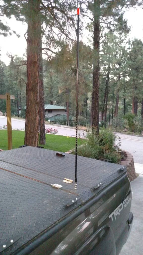

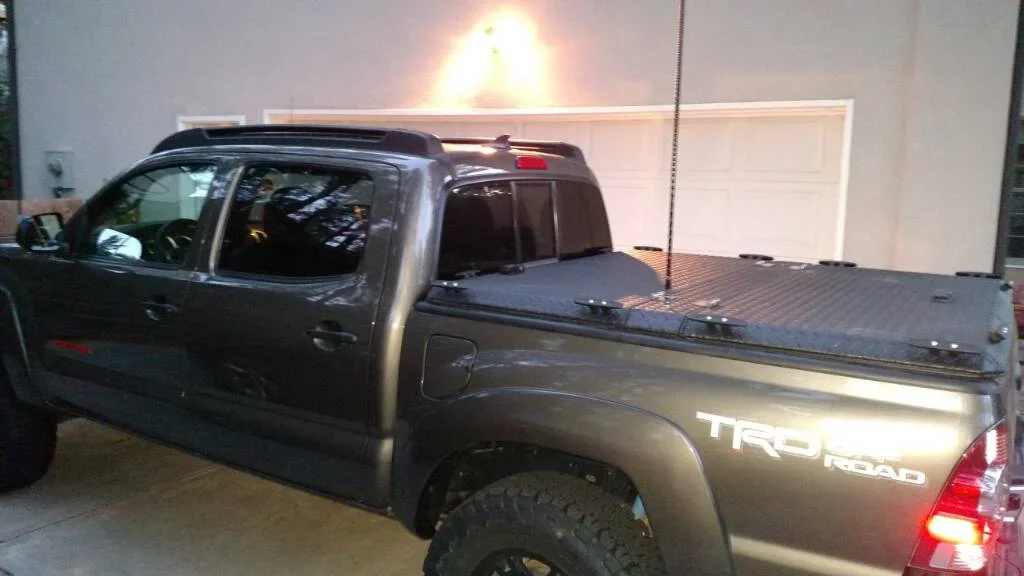

Similar issue, but Diamond Back cover, so after much deliberation and due to lack of reasonable alternatives, I drilled the cover. Routed the cable from under the passenger seat where my CB main board sits (split off face for install), through the opening in the carpet there and through the port in the floor right below. It was an easy routing. I am not sure how thick the metal is in the cab roof, but I would consider some reinforcement if you are using a sizeable antenna.
