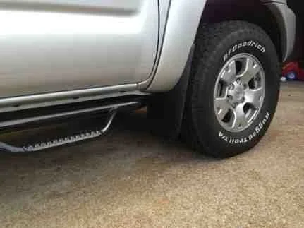

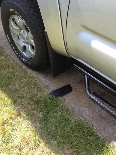

It was pretty easy and i didnt bother taking them off to do it....took 15 minutes using a pair of tin snips. In case anyone wants to know how here you go.
1. Measure how much you want to cut off and make a straight cut across the flap. Save the piece you cut off.
ImageUploadedByTaco Forum1371679755.626489.webpImageUploadedByTaco Forum1371679766.804675.webp
2.Take the piece you cut off and tape it to the back side.
3 Trace the rounded edges and cut them out.
4. Sand rough edges away (i dont carr how good you are w/ tin snips sand them anyway.

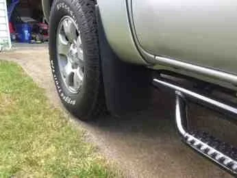

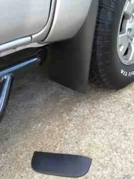

5. Snap pix of finished product.
ImageUploadedByTaco Forum1371679953.887880.webpImageUploadedByTaco Forum1371679968.404452.webp
There it is, no more scrapage on speed bumps. Things were lower to the ground than my mazda was.
