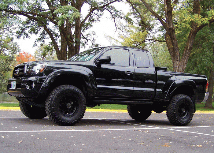

I'm looking to get my hands on a 2011-2015 Black Tacoma TRD Sport Access Cab with Grey Interior.
I want to debadge it and take the TRD stickers off. I will also lift it 3-4 inches and go with new tires and wheels. I have some questions:
1.) How easy/difficult is it to do the debadging and take off the stickers from an older vehicle? Will it look awful? Will it rip paint off? How different will the paint look that was under the stickers / badging?
2.) Does anyone know where I can get a Tacoma like I described above... maybe one that had everything taken off right after they bought it?
I want my end state to look something like the picture attached.
Any help would be greatly appreciated. Willing to fly to pick something up wherever.
Thanks!
Heat and Goo-Gone work wonders.
A truck that "young" shouldn't have any noticeable fading to the paint, though you may need to polish the are due to differences in wear and wax buildup.
Good luck finding one at a good price, you are almost better off buying brand new.

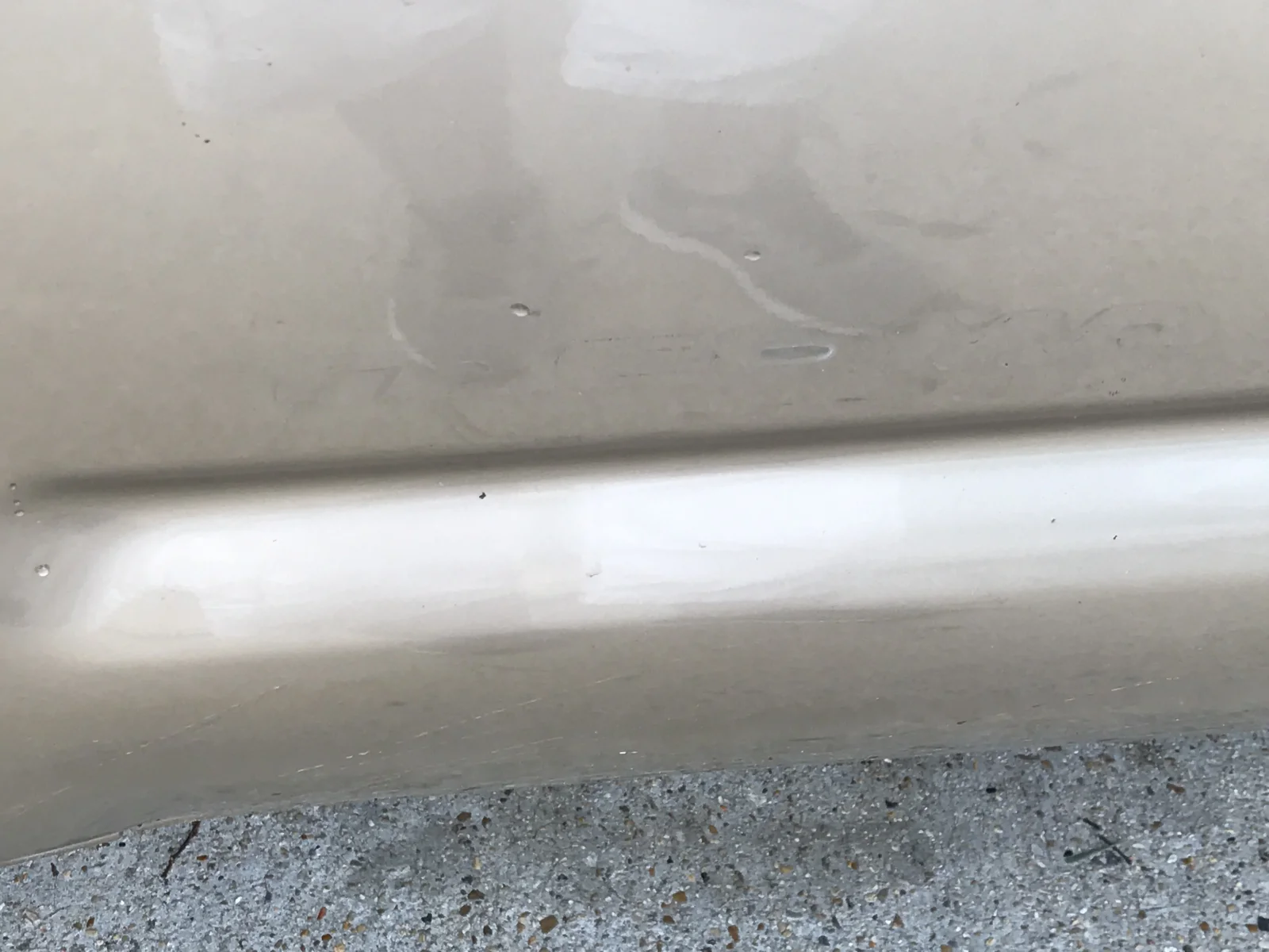

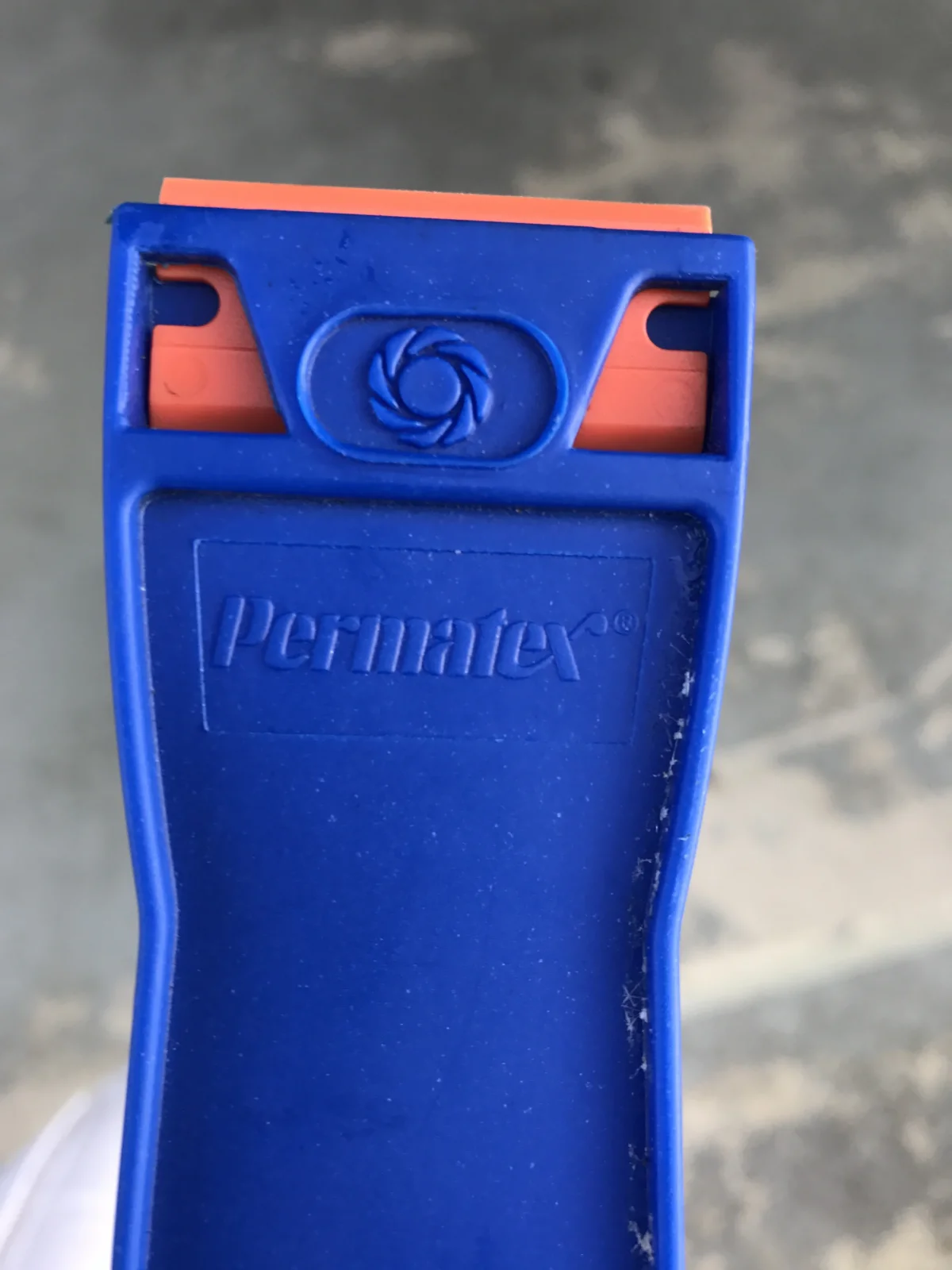

Like Garrick and DesertTan16 have said googone, heat, and a plastic scraper will debadge anything.
I did fishing string first then this to get the 3m tape off. I got chips in the paint outlining the tacoma letters on the drivers side. Gonna get that redone later.
