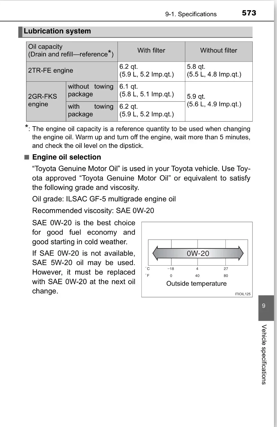

For gen 3 Tacoma's 0W-20 is recommended.

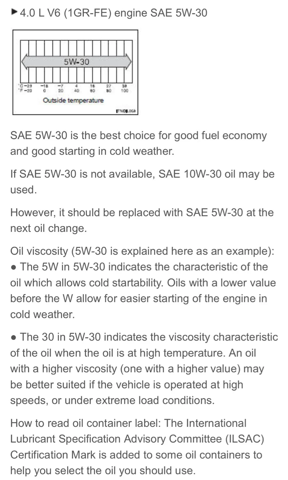

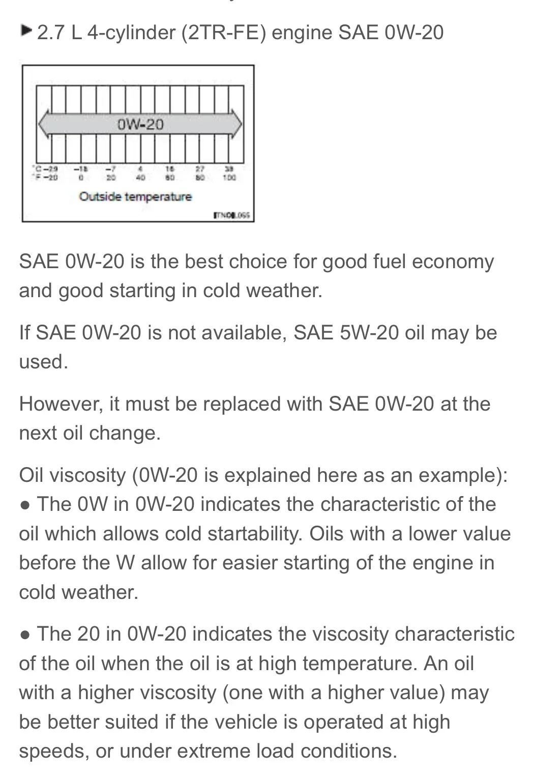

For gen 2 Tacoma's 0W-20 is recommended for the 2.7 liter and 5W-30 is recommended for the 4.0 liter.
Per the owner's manual you can swap 10W-30 for 5W-30 in a 4.0 liter but they recommend 5W-30 at the next oil change. And 5W-20 can be swapped for 0W-20 but the next oil change is recommended to be 0W-20 again.
