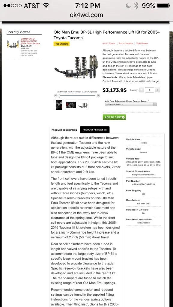

No i wasnt saying put them on now. I feel like they might already be on it.but ya i think im gnna order a nice ome kit. You think you could shoot me a link for a good complete kit that has everything i will need for front and back. Trying to stay in the 12 to 1500 range installed
This is a good solid lift , but, depends on the shop for installation price. Probably $500-750 with alignment. If you lived near me I do it for free.

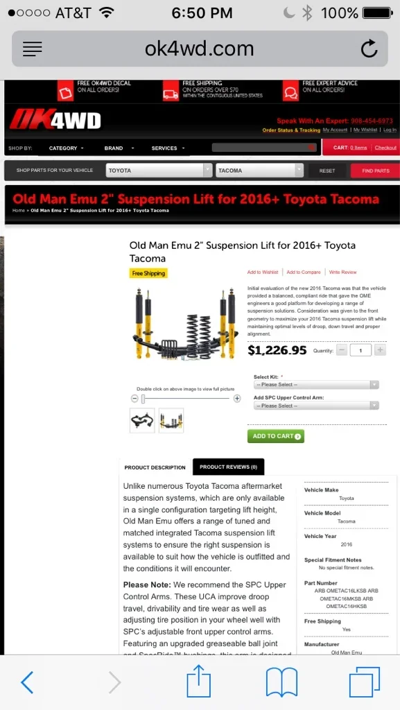

I just had this installed last week. It's great adjusting the ride depending on what off-roading conditions or load your hauling.

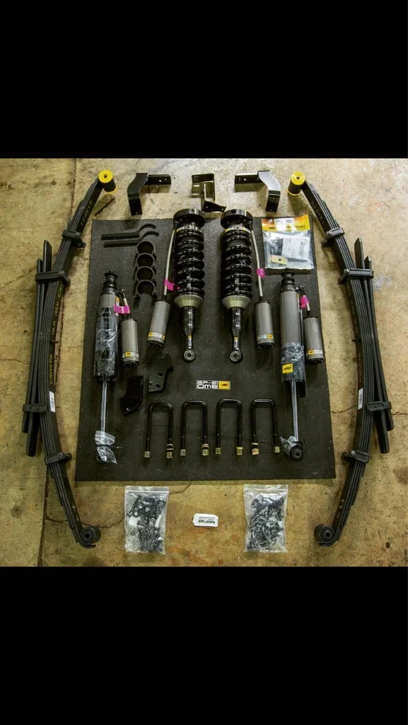

The rear springs were taken apart and we added one more long spring for more load and not a harsher ride. Also not shown are SPC Light Racing Upper Control Arms allowing more adjustability and a new grease able sealed ball joint. Body mount chop and then new welding on that.
BFG KO 2's 285/75-16 just on the factory wheels.
