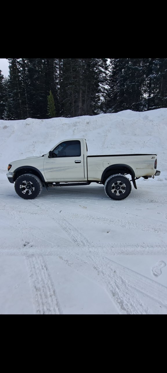

i noticed yesterday that the truck has a bit of a frown going on with 140 pounds of sand weighing it down back there
this is Probably NOT normal ??
... will try to get a pic for evaluation and go from there
they are frowning :(

all kinds of issues, its even loaded with 400 pounds of sand in the back
Ok wow now I have not a clue to what is going on back there under
Never had that shocksense and feeling of unstable wavy rocking
Going over the most nasty of seriously buckled highway pavement
Oh yikes :oops:
Who does one trust to know what heck is going on and needed fix
Do I have too much bagged sand back there weigh it down
:confused:
