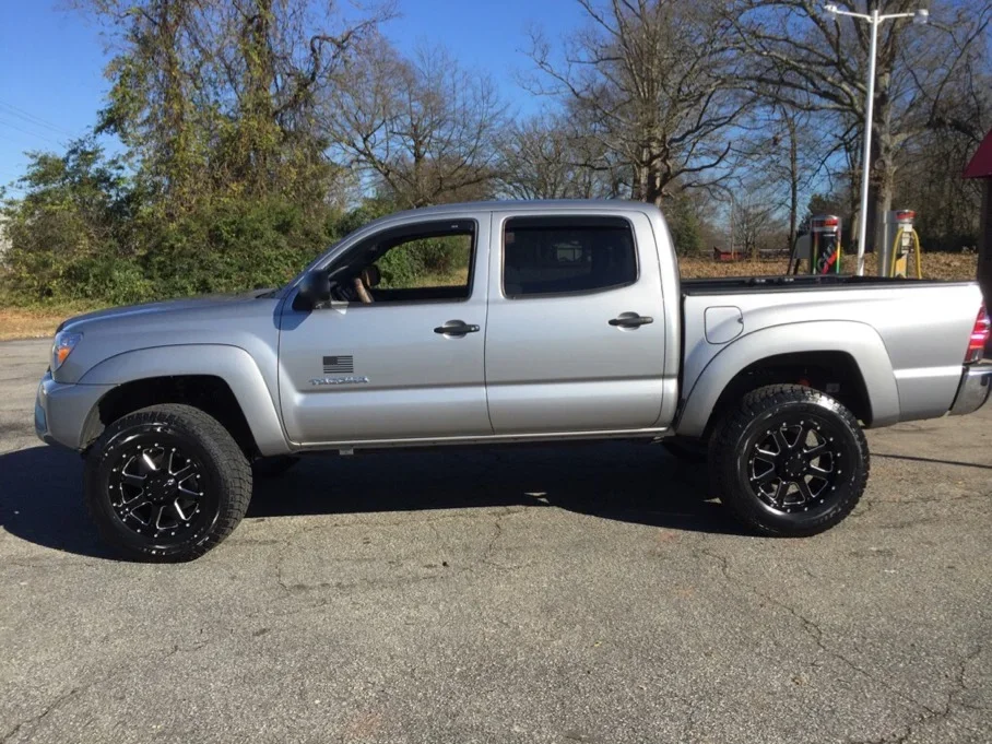

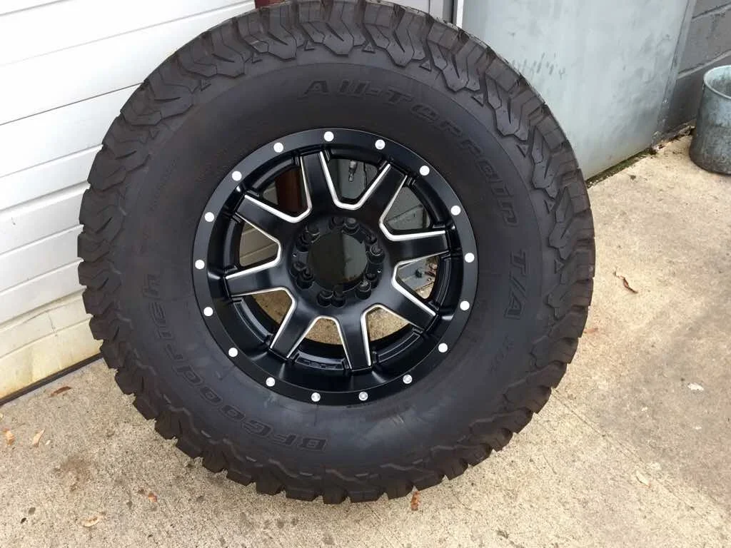

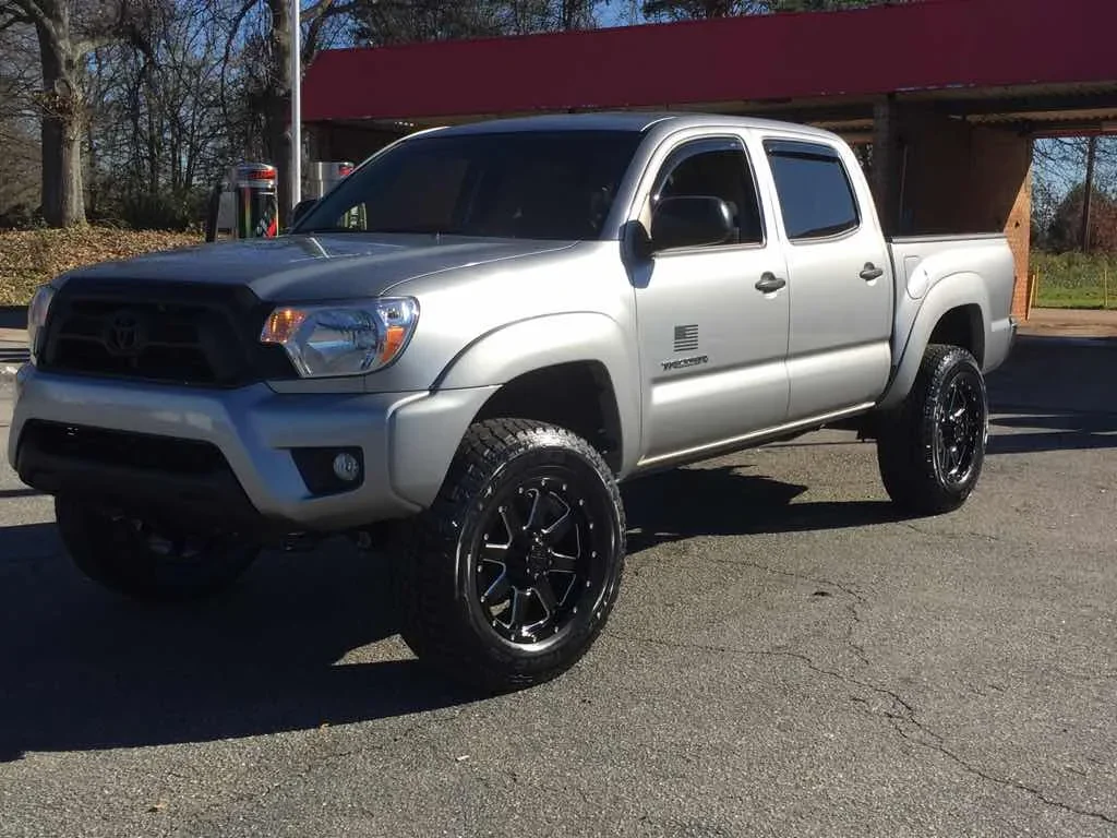

Finally got my tire situation fixed . what should I do next? Thinking light bar in the lower grill or tinted windows
Silver you drive the Abrams of yotas! Haha big money son! And I got 18x9 (-12 mm offset) wheels and 265/70/18 tires

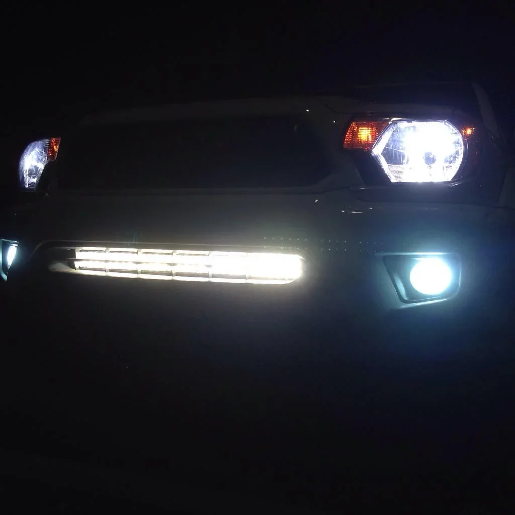

Hey jac what size is that light at? I got a 30 inch heading my way but wasn't sure how to mount it inside that area? I thought I would have to remove the bumper but wasn't sure of all. Also wiring how did that go?

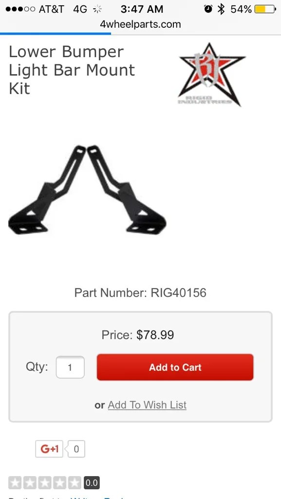

I had the rigid kit on my bumper before I got the steel bumpers, all you have to do is cut out the bottom "grill" and take the bolts that hold the aluminum brace on the front of the truck, slip those on and put the bolts back on, the hardest part is removing all the little clips that hold the bottom grill on...

It's 32in, drilled some holes into the metal crash bar and then mounted it like that, ran the wires along the inside through the door jam and neatly under the dash. Works great. Can't even see the wires unless your looking.
