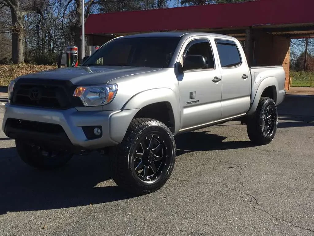

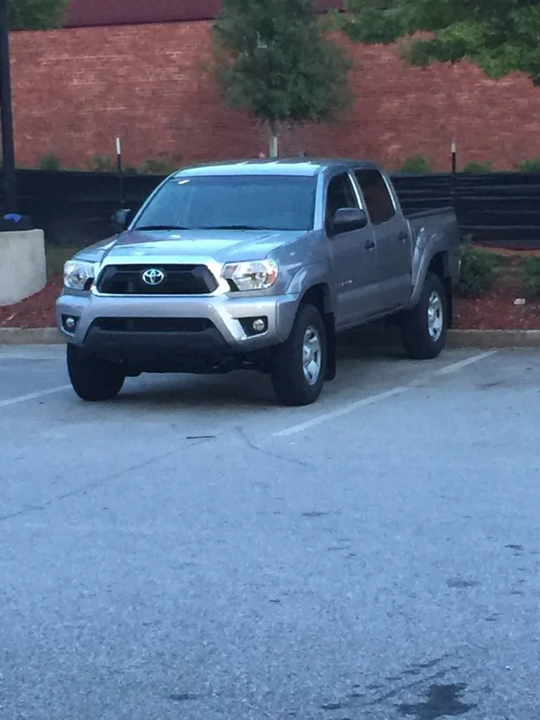

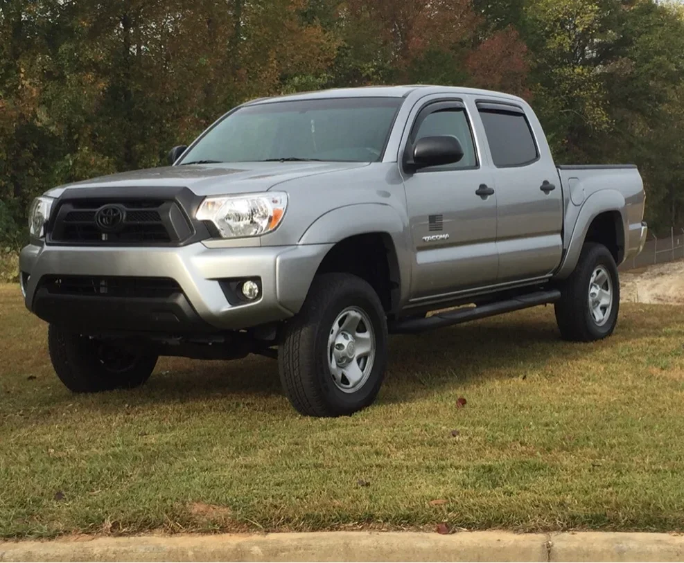

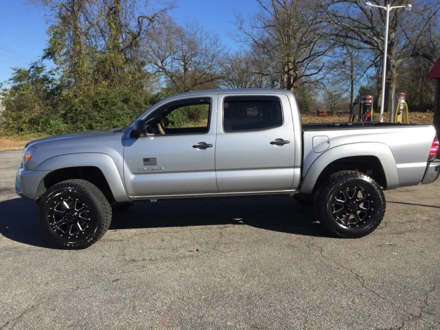

Little bit of my story line. Started out no lift, then did a ready lift suspension with 3". Now I have the lift with 265/70/18 tires with an -12 mm 18x9. I like the simple 3" lift. Not too much but enough to tuck some bigger tires. Plus sadly mine is only a 2wd so I didn't wanna go too high anyways
Did you install the driver side shim to account for the taco lean or no?
I actually did not bc you can't really notice the lean unless you stare at it. I notice it bc I'm the one driving it but it's not a huge concern at this point in time
