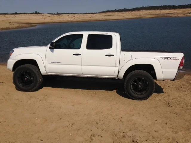

I have been searching the web for a good 1" rear lift kit to help offset the 2 1/2" front leveling kit I installed. Front is about 1/2" higher than the rear. I'd really like a 1/2" rear lift but don't see any available. Anyway, most I see are for 2005 to 2014. They say 2015 but when you check the specs show only up to 2014. Any ideas why?

Because I didn't like the nose up higher than the tail. Cali style is not for me. Also, with the front too high it's hard to see what's in front of you. Also shifts the weight a little back to the front. Also gives a level look which I like VS rear or front higher.
