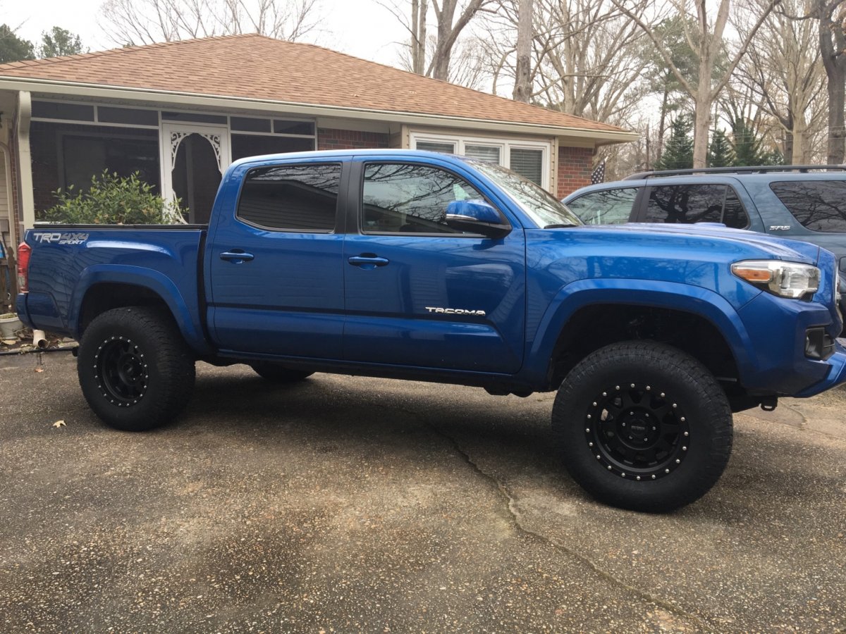

    Ish I have 2.25 front and 2.5 rear with 1 in block, Bilstein 5100 and deaver AAL
    OR17TRD likes this.

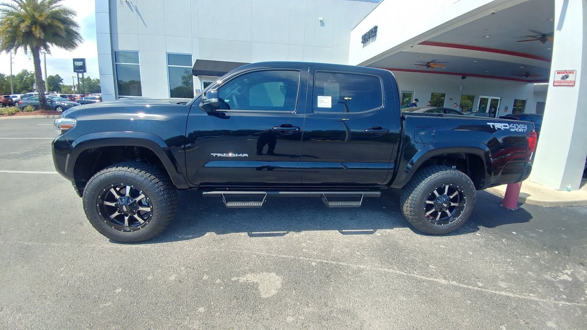

    I've got a 19 TRD Offroad on the way (~5/20) 2-3" front 1" rear leveling kit to be installed along with a TRD intake.
  7. paughms
    paughms Well-Known Member
    They told me this truck has the same leveling kit.
    SomeDirtyCuban, warakesTaco and B-Man like this.

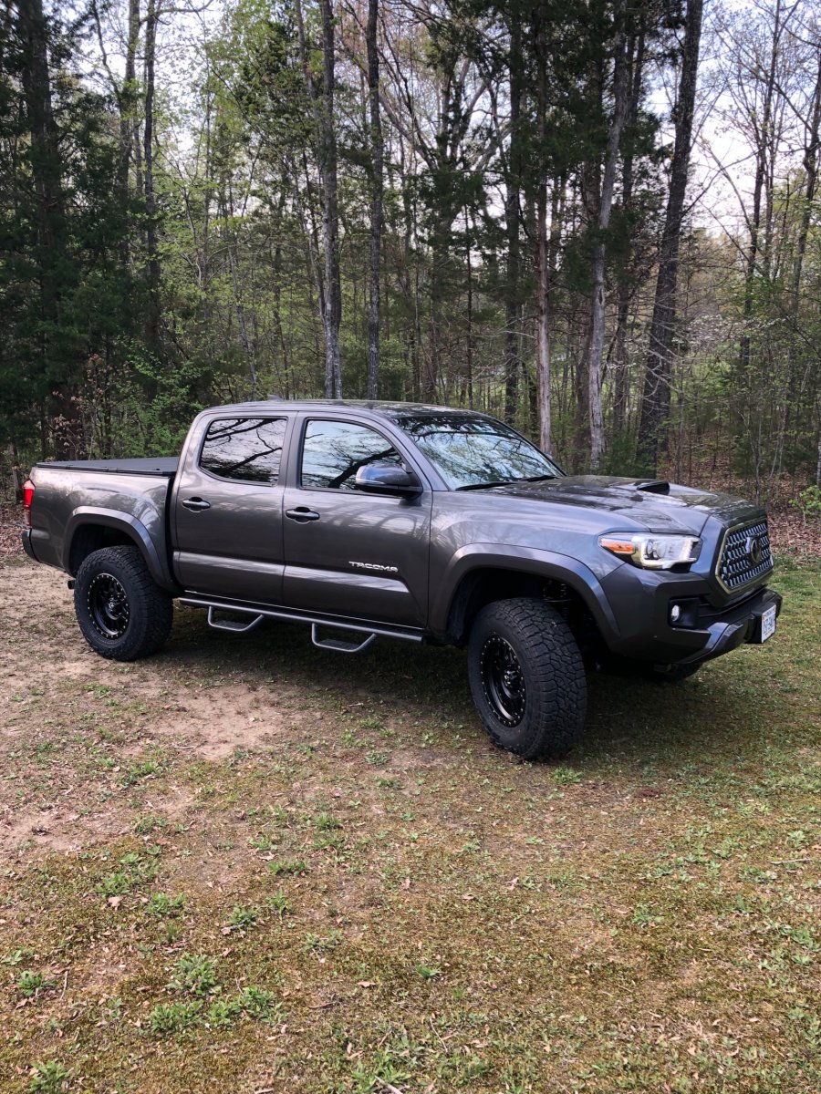

    doesn’t look too bad, mine as of now sits 35.5 (f) inches from the ground to bottom of fender and 37 (r) inch. going for 38 inch all around
    B-Man and paughms like this.

    Love that stance. Bought my truck and it came with a level kit but the front is a tad lower than the back and it drives me crazy lol looks like a 2 block in the back with a 1.5” in the front.
    paughms likes this.

    If you go above 2” you will want to look at replacing UCA. Also 2.5” front and 1” rear will give you a Carolina squat. I went 2”/1” and it comes out level. Running 275/70/17 with a -12 offset with no rubbing. IMG_1097.jpg
    OR17TRD, kp.taco and B-Man like this.
