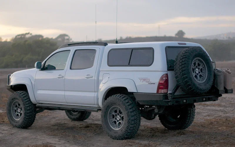

Tacoma Buff.jpg I know this has been discussed a thousand times but I need some current feedback. I have a 2015, TRD off road, shortbed. I recently put a fiberglass cap on the back and have some sag. I would like to lift the whole truck 2" to 3" and level it out. In the past I've read Bilstien 5100's for the front but what about the rear? I want to do it right but the budget is around $700. Do not want to do it myself. I spoke with the Toyota dealership and they had no clue. Help. Like the look of this photo.

View attachment 9580 I know this has been discussed a thousand times but I need some current feedback. I have a 2015, TRD off road, shortbed. I recently put a fiberglass cap on the back and have some sag. I would like to lift the whole truck 2" to 3" and level it out. In the past I've read Bilstien 5100's for the front but what about the rear? I want to do it right but the budget is around $700. Do not want to do it myself. I spoke with the Toyota dealership and they had no clue. Help. Like the look of this photo.
That truck is owned by TW user MrGrimm's mall crawler, I looked at his whole build. I think it's a 4inch lift/long travel. You could try going to TW and asking him tho
I believe the kit is from all pro, and it cost around 5000$ uninstalled

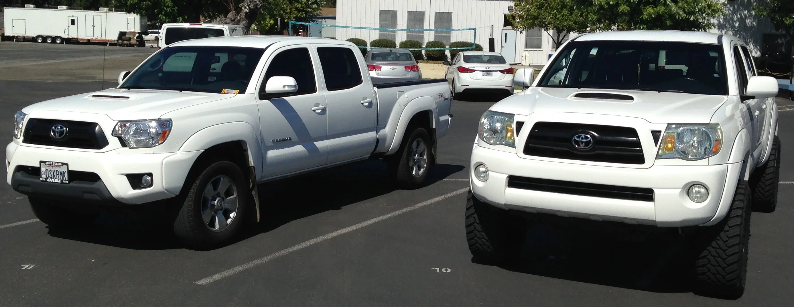

I bought the 3" lift kit (add a leaf) for my 2007 TRD Sport. Had to buy a 1.5" block due to the recall from Toyota. Easier to remove the block than the leaf. Attached is a pic of my truck with the block in the rear. The kit cost $499+tax so about $545-ish. My friend and I installed it. The leafs will be installed next week since the recall will be fixed this weekend. I have 18x9 -12 offsett and 33s. Had to cut a little off of the fender. You can barely notice it, though. I took the pic next tona stock TRD as a before and after

Looks good, spacer?
Thanks! No spacers. I like how it doesn't stick out too much. It is just right for my taste. Btw, I have the Pro Comp 3" AAL kit. Failed to mention it before
