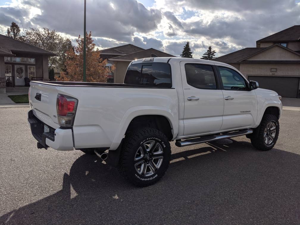

    If this helps... pic of my 2019 Limited with 3-2 Readylift.
