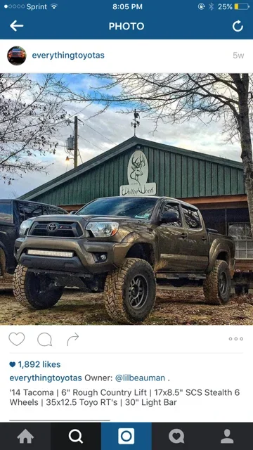

Got a 2014 tacoma just bought a 30" LED lightbar , any suggestions on how i can install it? Im Putting it under the grille on the bumper, is there any thing i should know when installing? This is where in putting it.. ImageUploadedByTaco Forum1455659334.462275.jpg

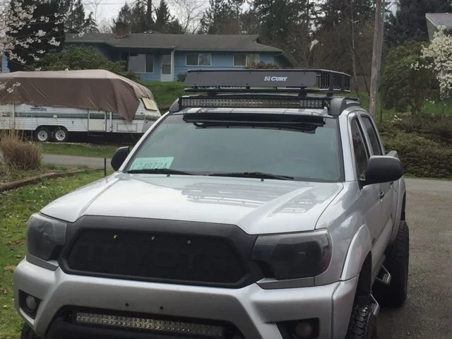

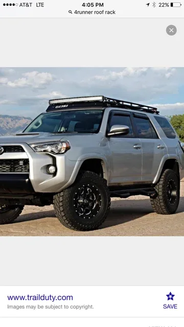

Above the windshield is gonna give you a blinding reflection off the hood at night, I'd keep it on the front bumper or set the light bar back where the light won't hit the hood, my lights are on my front bumper and it's definitely the way to go

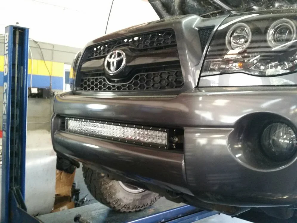

I did this to mine. I got it from rough country. The light bar and brackets came with it.. What do you think?
Took all of about 15 min. to mount.

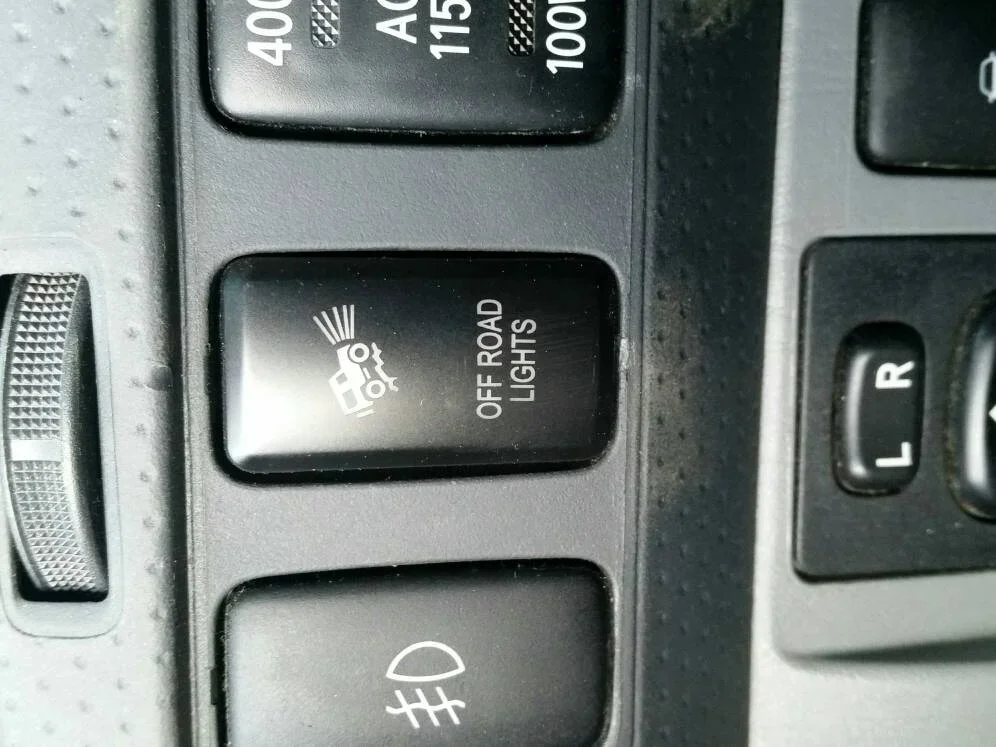

I bought and wired the switch separately. $341 for everything.
