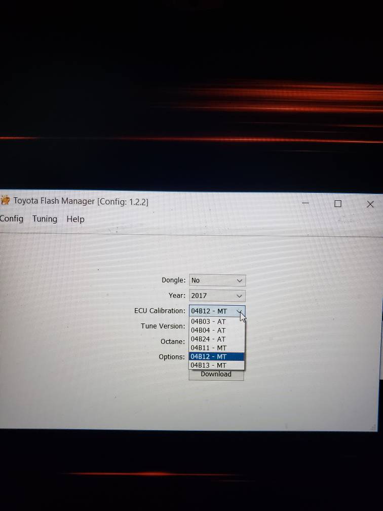

  11. OP
    CHROMETACO
    CHROMETACO Member
  12. Crawdad
    Crawdad Well-Known Member
    The ECU ID?
    One of the first steps is the "Identify" button on the far left of P5 Flash Utility. That'll tell you which ECU you have, pic below.
    When I did this, I had to email that into him to get the right tunes emailed back. Idk how exactly it works now... the tunes are available for download in Flash Manager for each ECU... much has changed. Lol
