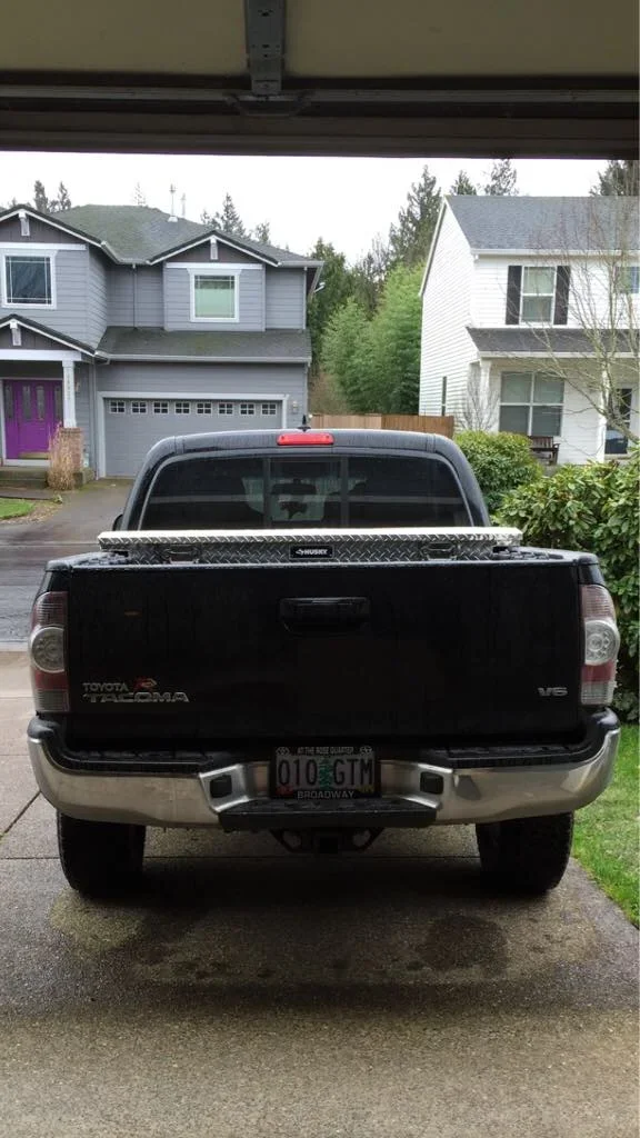

Does your Tacoma sag a bit on the driver side? I hate to get OCD about stuff, but I notice it on my Tacoma more than others. By the way, I'm sorry if this causes an OCD trend :)
They naturally sit lower in the from and to combat that, there are a ton of leveling kits to choose from thy will bring your front end up to the same Height as the rear. If it is leaning slightly to one side it could be a back shock or coil. Even more simply check your tire pressure.

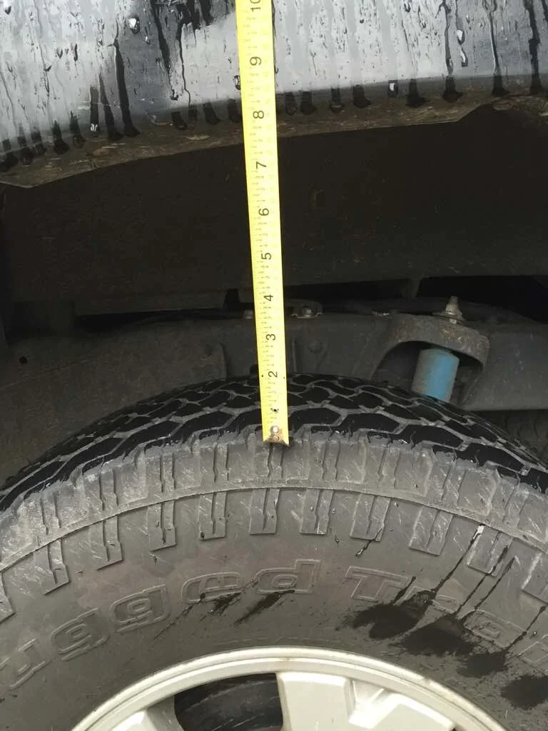

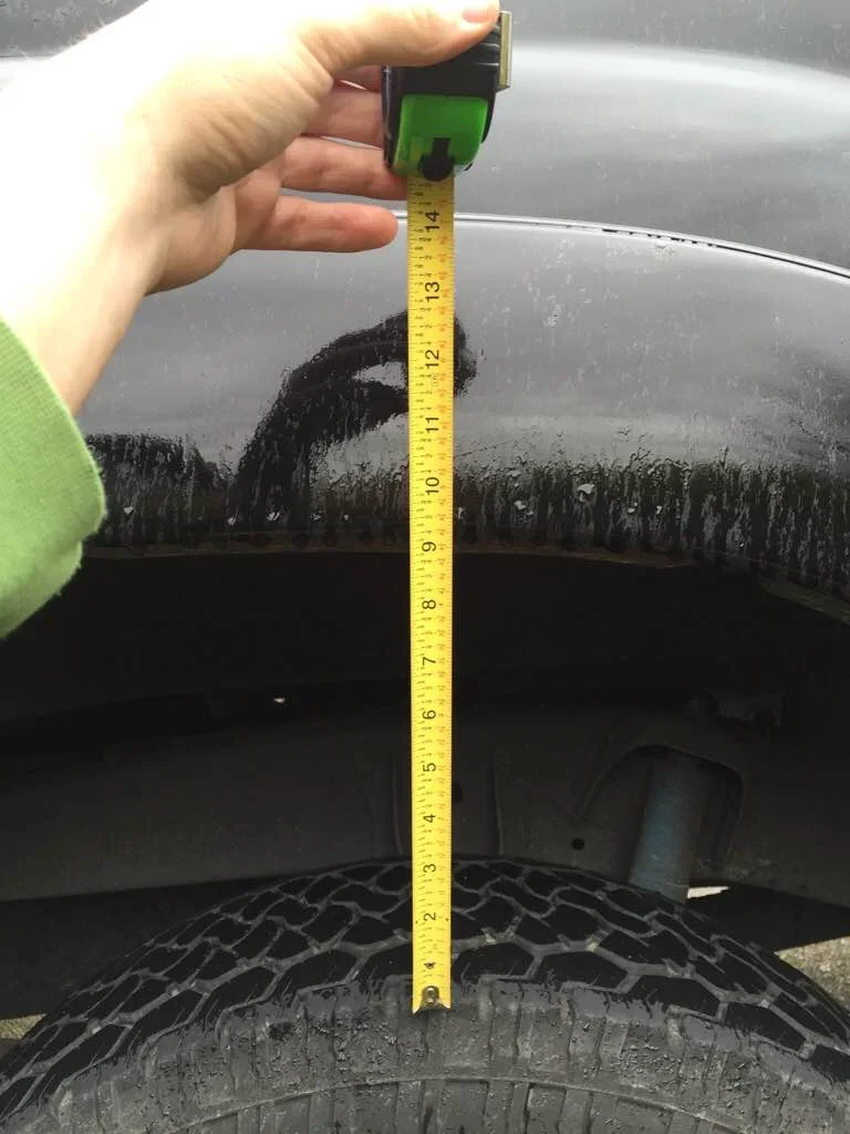

Here's what I'm talking about...
8" gap below driver rear fender
9" gap below passenger rear fender
It's almost as if the positioning of the driver leafs isn't the same as the passenger leafs. I'd get more technical with my measurements and discoveries, but it's starting to rain and I have dainty skin ;)

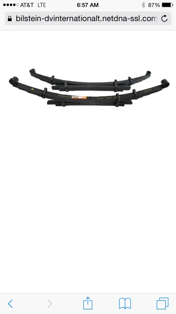

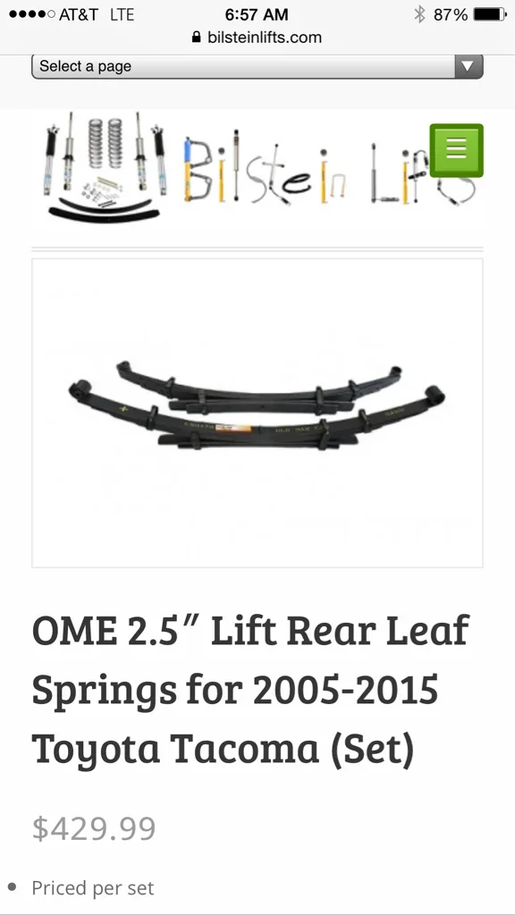

I'm gonna try OME rear springs and see! The ones on my truck are crap from Toyota !
Post some pics if you do. I agree. Factory springs are junk. Seems like they have more recalls with those lately.
ImageUploadedByTaco Forum1421409465.132647.jpgImageUploadedByTaco Forum1421409553.624232.jpg

After checking with a few other sources, it's entirely because of the lift. Just needs an axle shim kit.
