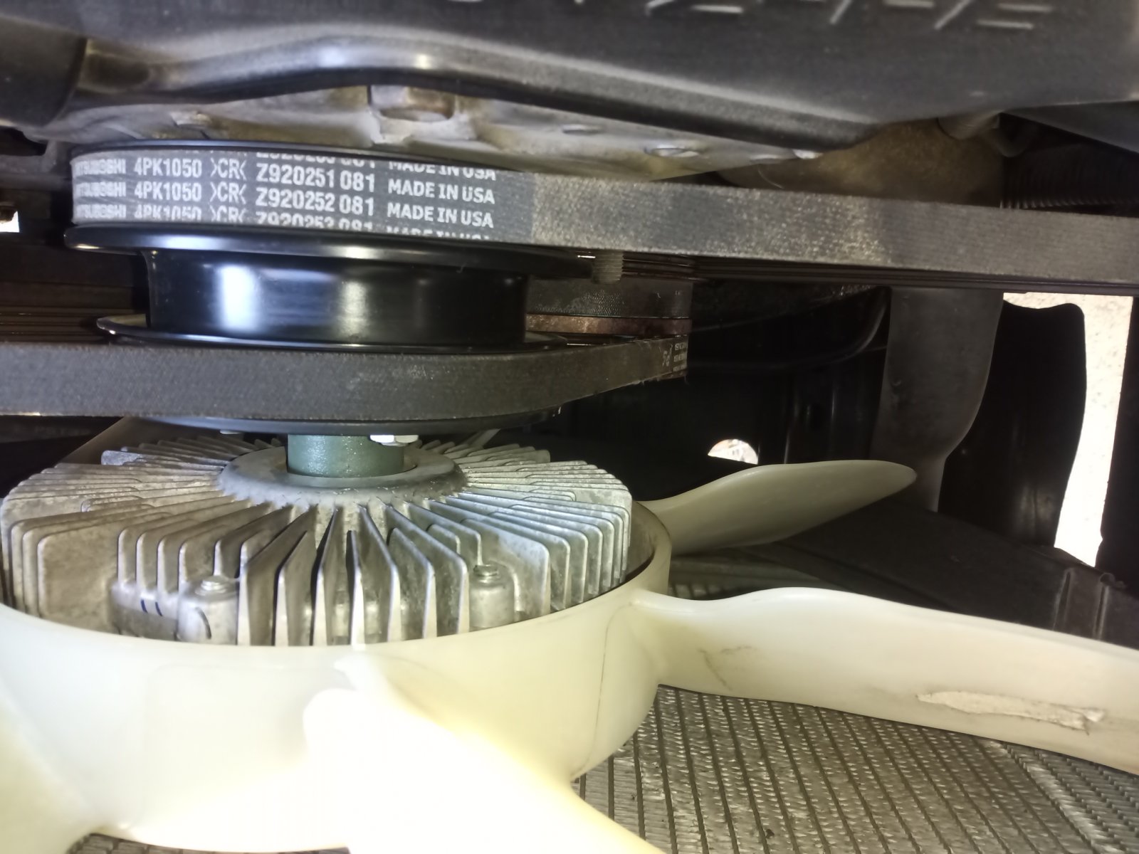

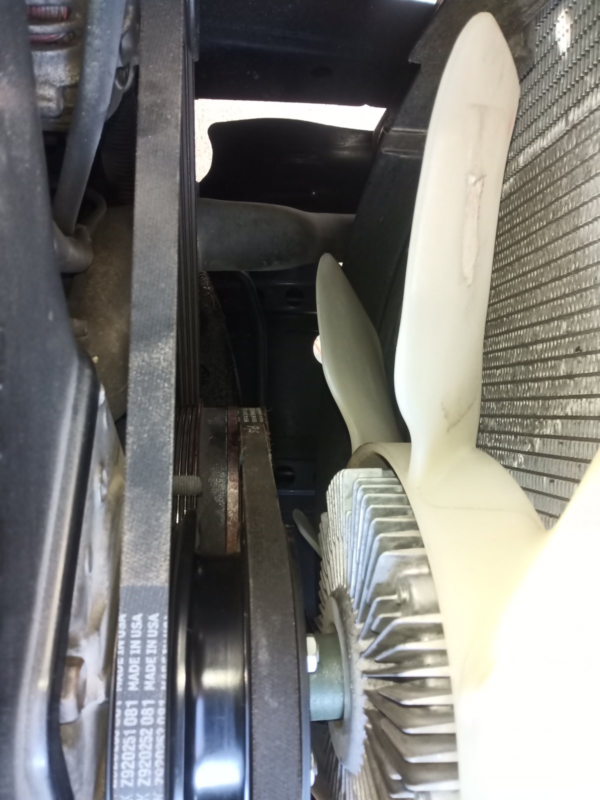

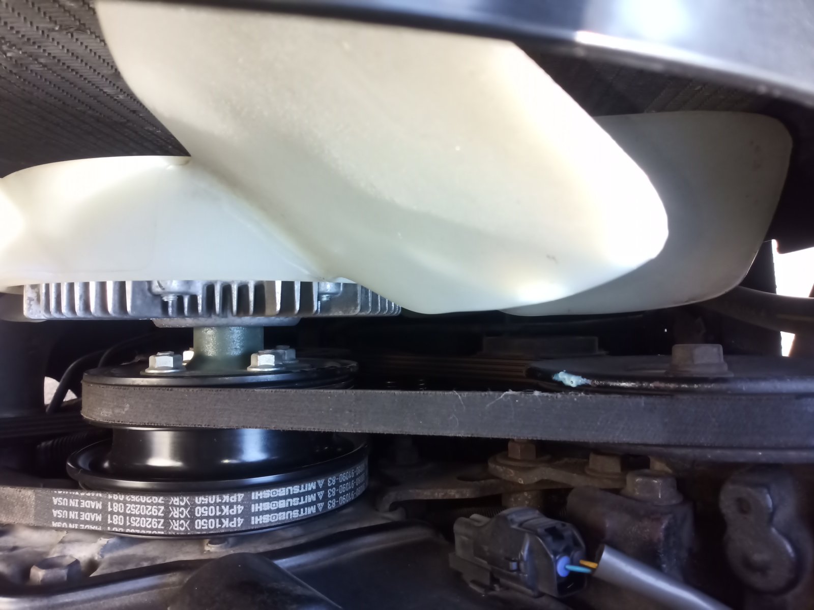

How are these drive belts looking?
Roughly 85k miles on 'em
I was trying to clean up that crank pulley with a cotton ball so maybe some fuzzy remnants of that left fwiw
For the cost of belts...I'd replace them.
They are showing some edge wear.
Best way to check the belt is to look at the pulley side. Any glazing or shiny or concave sides or cracks means replacement.

Its a crap shoot with belts how long they might last. Some are just made far better quality than others. I can tell you once you spot any crack in them, its time for replacement. I recently replaced the belts in a snowblower i rebuilt the auger assembly on...both the drive belt, and auger belt were toast, with the drive belt nearly broken in half. On my new holland tractor I've got the same aftermarket clutch belts i've had on since the 80's that run my pto's that are still in decent shape. The originals failed in 15 years. Pretty hard to beat these mitsubishi belts. I think the original ones were dayco.
the current belts do appear to have some outer edge wear
i can compare edges with new belts when they arrive

Another way to tell if the belts are worn. Place a straight edge across the pulley flanges, if the top of the belt is below the flange edge, then belt is worn needing replacement.

I've done that, but the belt isn't necessarily bad, they tend to stretch some over time causing that. I've had several belts look that way, but after resetting the tension they were fine for a very long time.

The belt flexes around every pulley transmitting power on the sides of the belt. Not the top or the bottom. Only the sides transmit power. When the top of the belt is below the pulley flange that is an indication of the belt sides are worn. Belts are pretty cheap, although can be a PITA to replace, they endure a huge number of cycles.
I consider them a maintenance item that needs inspection. Any cracks, glazing, frayed edges, concave sides, top below pulley flanges........replacement time. I've probably replaced a few prematurely, but I have never had a failed belt leave me stranded. I do a visual inspection at each oil change. I do this while waiting for the oil container to finish draining. Takes all of about 30-60 seconds to inspect.
The wide poly-v type belts are difficult to inspect for concave sides or top below pulley. Just look for cracks, glazing, frayed edges. Always look at both sides of the belt.
