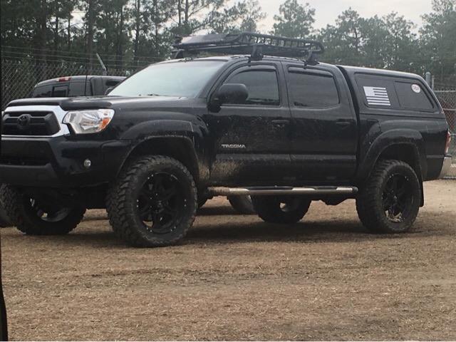

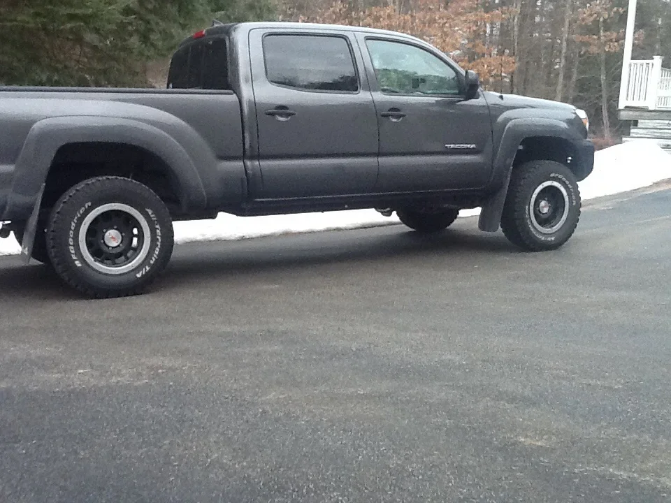

Running the 3" Rough Country Suspension kit on my 2015, 265/70R/16 on TRD Bead Lock wheels. I think Rough Country recommended 265/70R/17 for the tire size but you could go up to 28x10.5. Installed at the dealer so no warrantee issues, pretty much max you can do without changing parts. Kit included 3" strut spacers, 2" rear blocks and shocks.
Need to kill those mudflaps bud lol
How is the spacer lift working out for you? I've heard it will damage parts overtime due to incorrect vehicle geometry. Keep in mind my truck is not lifted and I have very little knowledge on the subject.

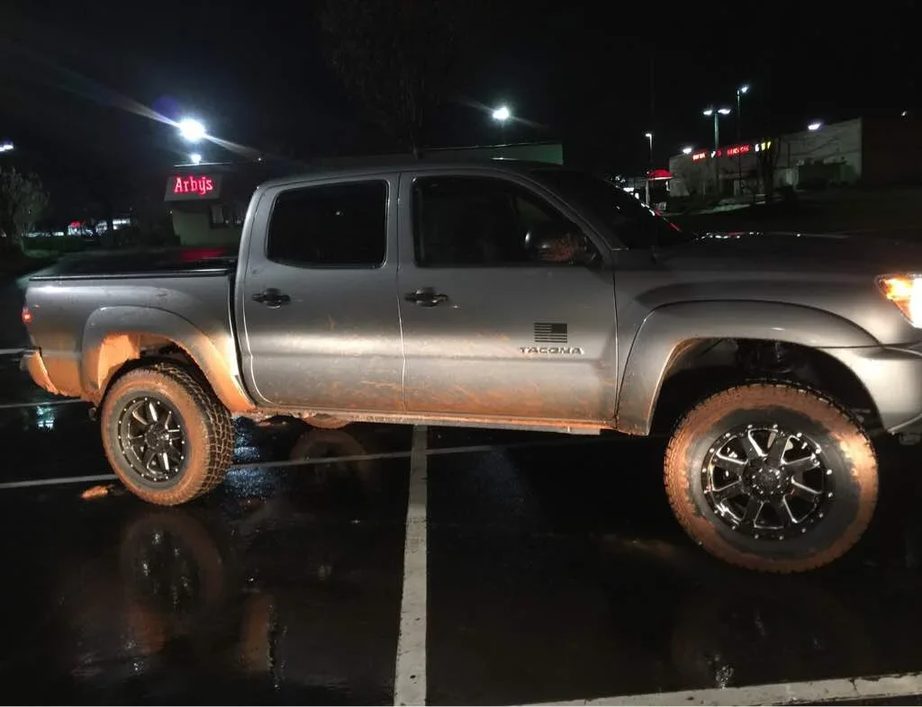

You can do spacers without damaging anything but you have to get top quality which will include maintaining factory angles of the rear differential. My rear spacer is tapered to maintain the diff angle. I'm running ProComp 2 1/2" front and rear 7/8" tapered aluminum solid block.
