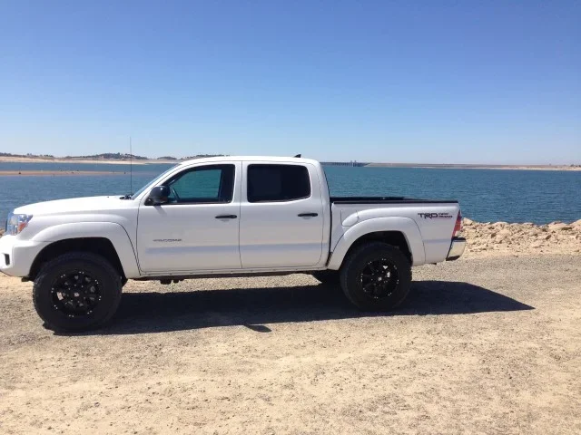

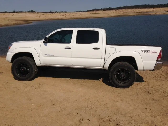

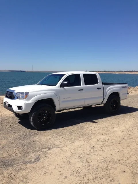

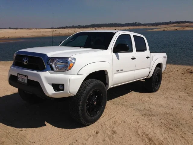

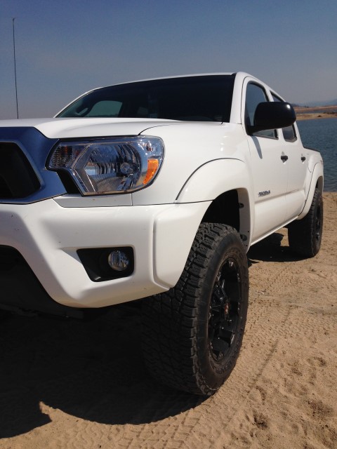

What size tires do you want to go with? I went with 33" tires on 18" wheels. Pro Comp 2 1/2 leveling kit up front. 1" rear block for leaf springs. Cost was around $200.
Wow that's not expensive. It's a lot cheaper than what I was quoted... I'm trying to go with a setup no larger than 33s. 18's would be great, but would prefer the meaty tires, so I would most likely go with 17's or possibly even 16's. Do your tires rub with this height?
Im assuming that your mpg sucks now with bigger and heavier wheels? Not like it really matters to me, but just curious. Also how does your truck ride with this lift ?
Yes, mileage went south a bit and ride also but not much. I went with 18" wheels to keep from that balloon look with fat tires. Tires are Nitto Terra Grappler II which are 10 ply, low noise but still an aggressive tread. Pics are before I added the rear 1" block to completely level the truck. The last pic does have the 1" blocks in rear.

He's looking for budget lift. I agree spacers are not the way to go but front spring extension does not hurt anything as long as you don't go too high which can cause alignment issues. A 1" tapered block also will not hurt the pinion angle. If you do it right you can get up to a 33" tire with the 2 1/2" Procomp front leveling kit. If you like the front higher than rear you don't need the 1" tapered rear blocks. I prefer the block to level the truck. Now, if you want to put coil-overs on, you have to spend some good money. It's your truck, just don't go too tall if you do a leveling kit.

Again, 2 1/2" leveling kit will hurt nothing. My 2015 has been serviced by the dealer I purchased it from and they say it is fine and will not hurt anything. But that is maximum. The ride changed little until I replaced the stock wheels and tire to the over-sized off-road tires. You are posting pics of a completely different setup. And if you're jumping off-road you will break **** regardless. I have over 10,000 miles on my leveling kit, taken it off-roading many times and NO issues including alignment. Stop trying to scare this guy. I agree coil-overs are great but for a minor lift and not trying to make his truck do jumps, he will be fine with a leveling kit. The pic of the bent shock looks like it was at the end of it's life and the shock was frozen. Not from any leveling kit from what I see in the pic. Regarding 10 ply VS 4 ply the difference in cost was minimal. Like maybe $10 or $15 more each and give you about 40,000 more miles on the tires. Also, very difficult to damage them when off-roading. Also great if you are going to trailer anything. Read up on them.
