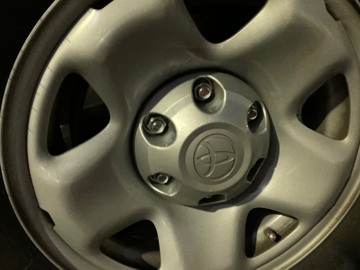

Hi probably really stupid question but I can figure out for the life of me how to remove the center caps on my 2019 SR wheels. Read where some say the snap on some say you have to remove the lug nuts. Anyone know? IMG_1371.jpg

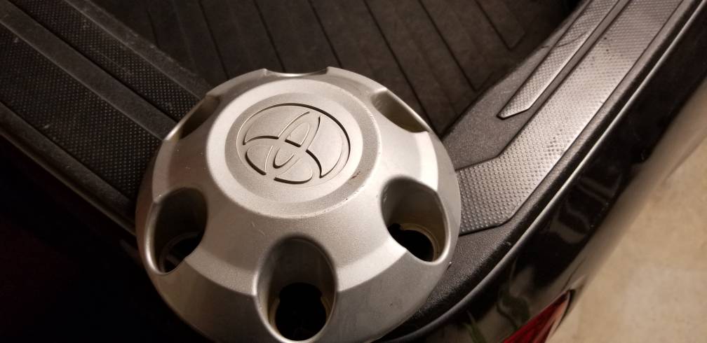

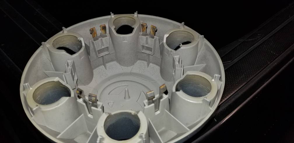

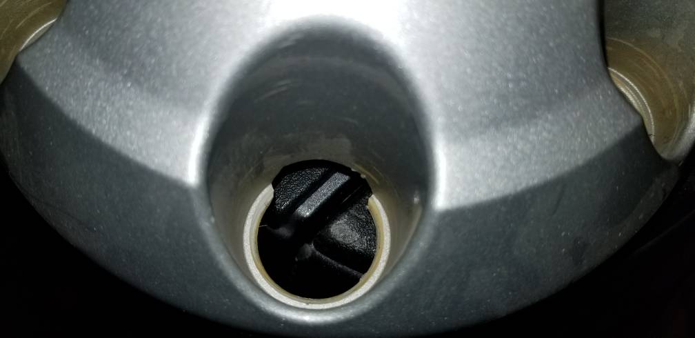

Ok. Here's the lowdown on the center caps. The lugs are secondary security and must be removed before you pop the caps off. The photos below show the lug lip (if you zoom in you can see where the lugs pressed on the lip). The last photo shows the clips on the back.20200218_173227.jpg20200218_173250.jpg20200218_173314.jpg
