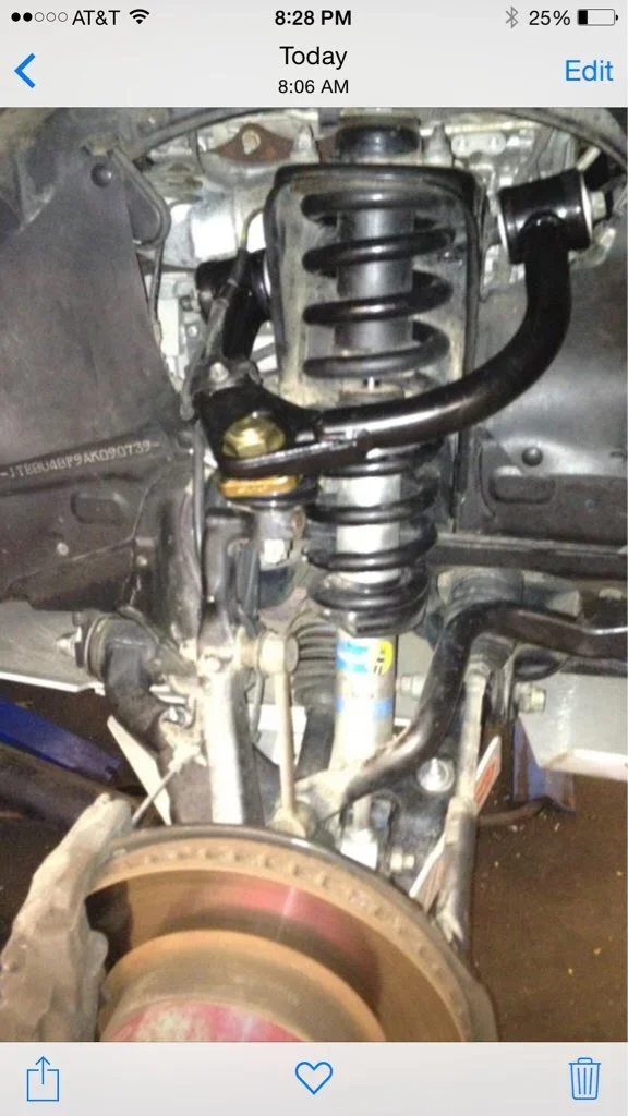

My front FJ setup, bilstein 5100 OME 886 spring,Light Racing UCA, extended braided SS brake line 2" wheel spacer.
