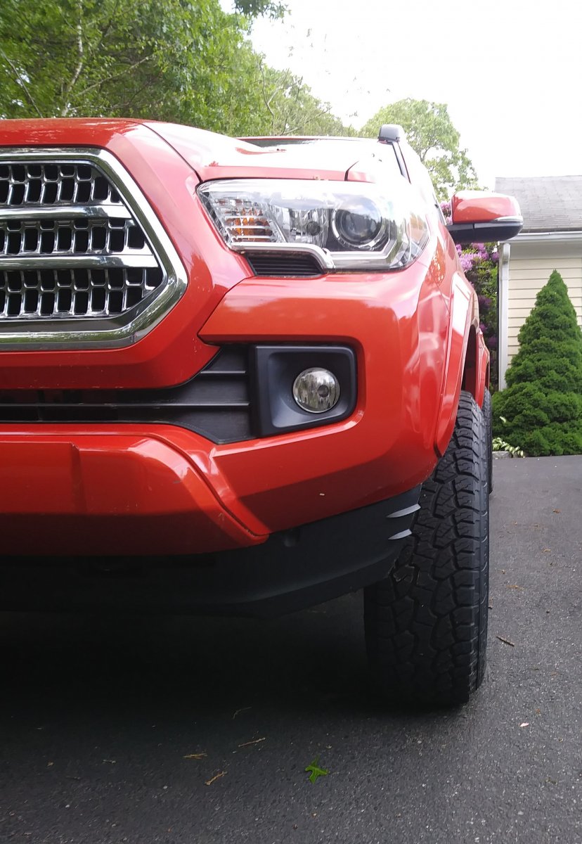

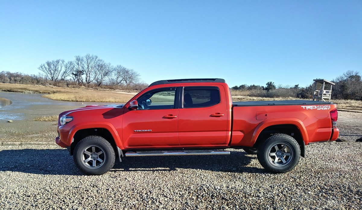

    2018TuRD Well-Known Member
    I run 265/65r18....same dimensions as what you are looking at...so here's a pic for reference

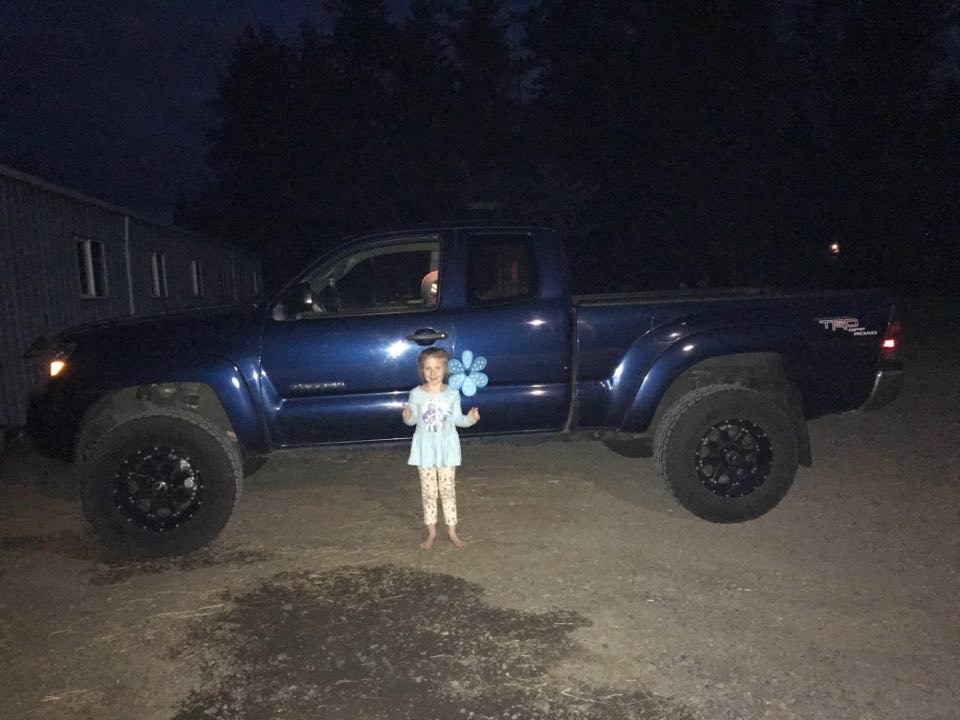

  6. Default User
    Default User Well-Known Member
    265-70-17 on 17x9’s with -5 offset
    No issues at all

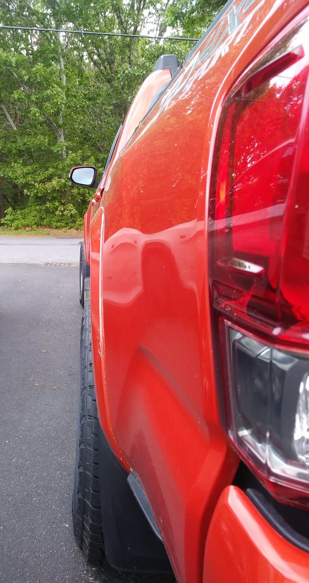

  7. Cape taco
    Cape taco Well-Known Member
    Have 265 70 17 with 17x9 -12 offset 4.5 backspace. .They rubbed in fender with mudflap on . Did not want to take off flaps .Bumped it up 1.5 all around no mer rubs . The 8's probably would not have rubbed different offset and backspace . 20181229_122721_HDR.jpg

  8. Default User
    Do you have a pic to see how far the -12’s stock out from the fender?

  10. Cape taco

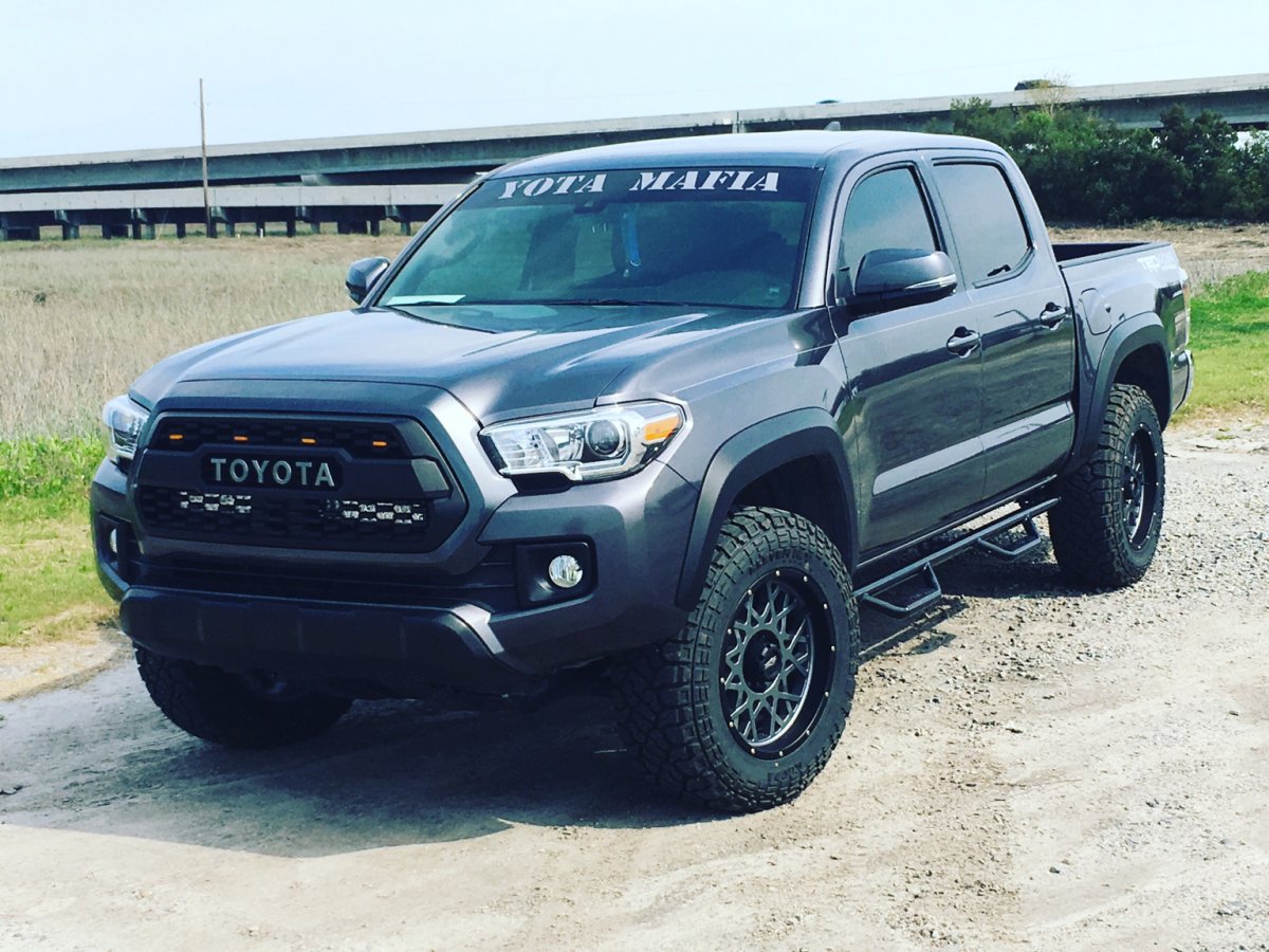

  11. jessebree7
    jessebree7 Member
    LT285/70R17
    tooter, OR17TRD and B-Man like this.

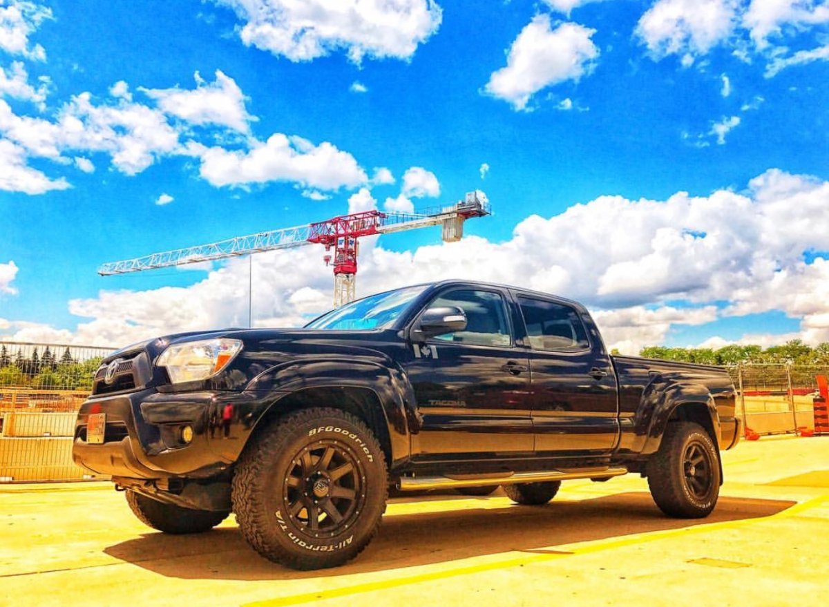

  12. jessebree7
    jessebree7 Member
  13. Cape taco
    Sweeet!
