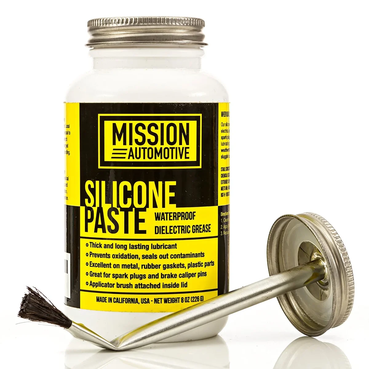

I use this stuff IMG_2850.webp The super lube would be fine it says it's Anti Friction, Ball, Roller, Wheel Bearings, Hubs, Axles, Chassis, Shocks, Springs compatible.
