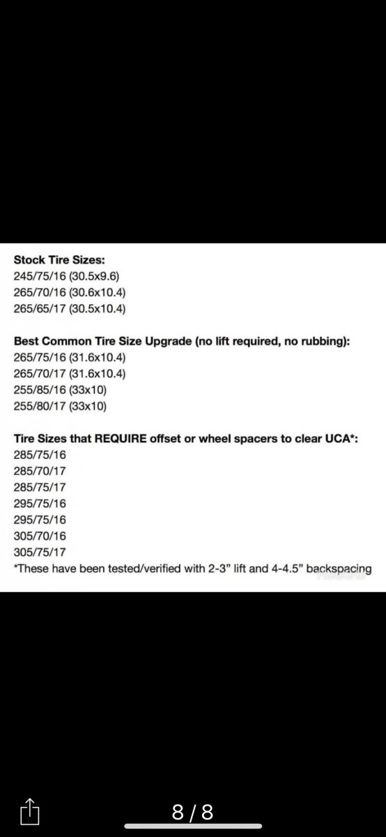

I found this lift kit that's in my price range. Can anyone explain the options for ordering as there are several. Also what size of tires do you think I can get with this kit?

As far as tire size you can refer to this guide.
