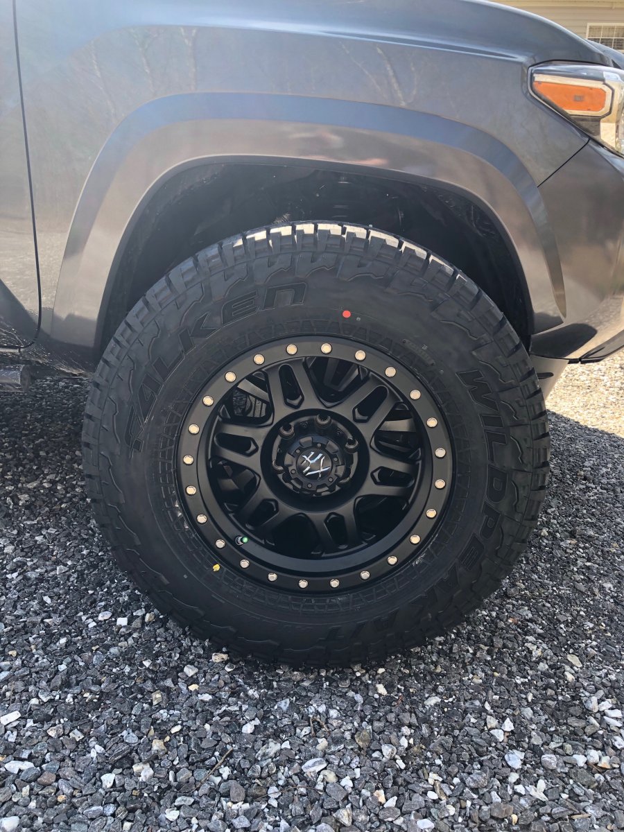

  3. rut1095
    rut1095 Member
    What I’ve found out is if you go higher than 2.5” you have to change the UCA. I’ve seen where 33’s rub with a 3/2. Are you staying stock wheels? I’m doing a 2” on Monday and going with 275/70/17 and a -12 offset wheel. Not quite 33, but good enough until I decide on a 3”, 4” or 6”. If you have a Sport then trimming might have to be done on the valance. I’m just going to remove mine completely and maybe put it back on later. I’ll have firsthand knowledge come Monday so I might be able to help better then. That is if no one else chimes in.

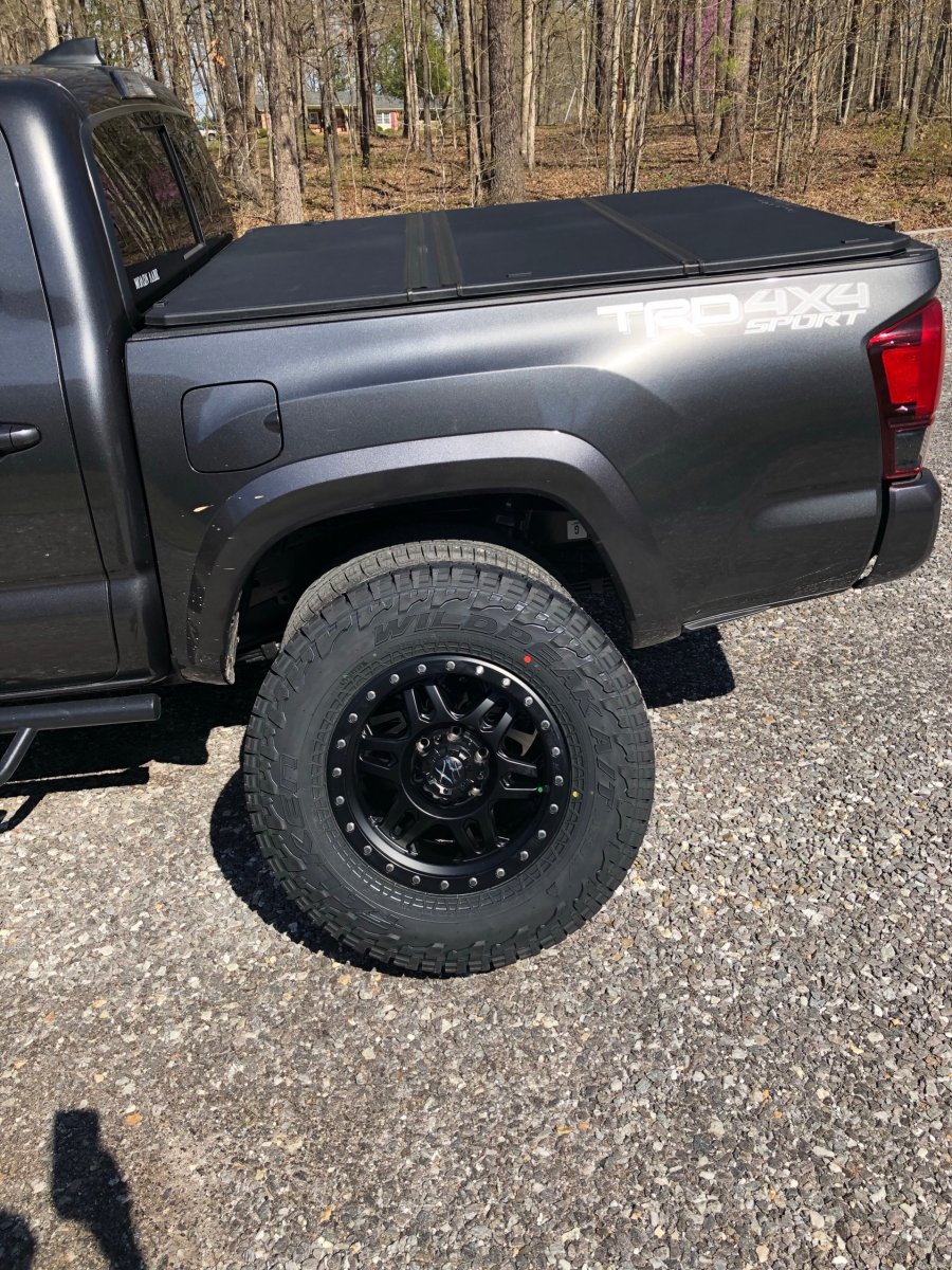

  6. rut1095
    rut1095 Member
    Not mounted. Leaning against the 30” tire, Outside of the wheel well.

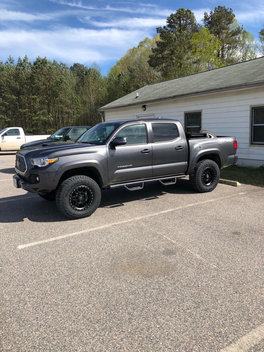

  7. OR17TRD
    3” lift with 285/75/16
