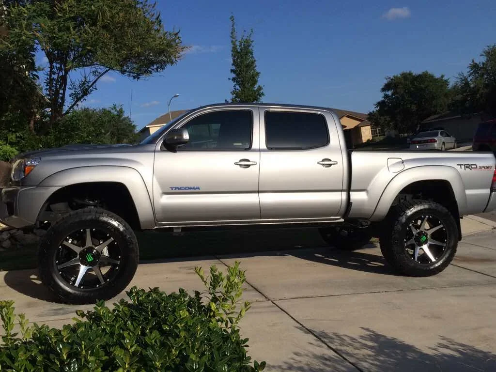

To be more accurate, figure out the circumference of new tires and then figure out what percentage bigger they are than stock. When you get your ODO reading add that percentage for a more accurate mileage traveled. Then divide by gallons used. I do this when I fill up. Use receipt to see how many gallons to fill up and ODO to see how many miles I got out of that tank (also add 15% for larger tires). But getting more than 300mi. out of these big V6's on a lift and larger tires is pretty good. You're ok. Your truck is operating normally. I'm now getting 16mpg avg. in this...ImageUploadedByTaco Forum1416327549.576207.jpg
