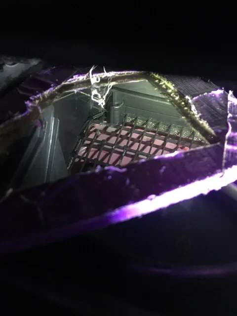

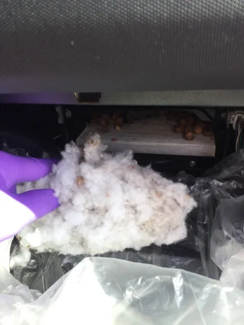

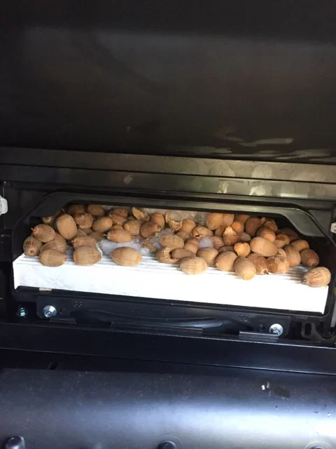

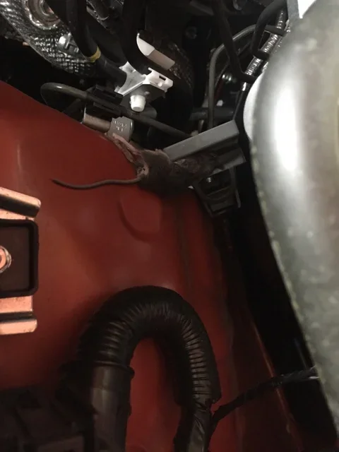

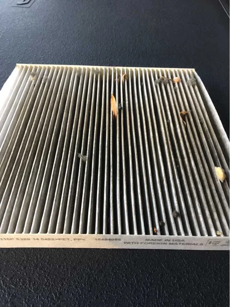

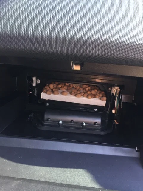

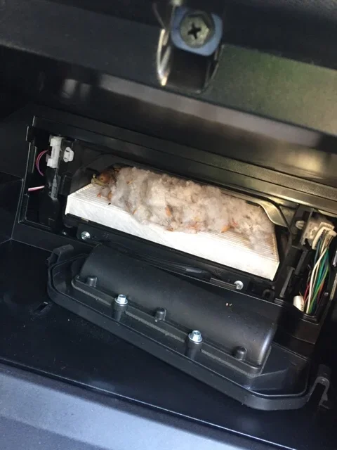

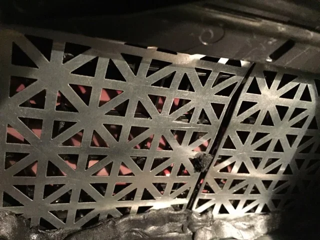

My 2016 sport that's 8 months old started to give off a distinct mice urine smell last week through the heater vents and I decided to take a look at the cabin filter.... holy crap!!!!! My pics tell the story of how a field mouse chewed the cheap plastic grill on top of the filter(very cheesy Toyota). I fixed it in about an hour and killed the mouse. Very disappointed in the quality. ImageUploadedByTaco Forum1481071073.176266.webpImageUploadedByTaco Forum1481071088.984118.webpImageUploadedByTaco Forum1481071099.791986.webpImageUploadedByTaco Forum1481071111.202743.webpImageUploadedByTaco Forum1481071128.754504.webpImageUploadedByTaco Forum1481071151.603629.webpImageUploadedByTaco Forum1481071164.940055.webpImageUploadedByTaco Forum1481071183.254300.webpImageUploadedByTaco Forum1481071199.962277.webpImageUploadedByTaco Forum1481071215.933171.webp
Thank you. It's been a few days and I have been setting the mouse trap in the engine compartment while at work in case there are more.... nothing yet.

I had this same problem. A more permanent fix is to remove the filter box and put some window screen on the intake spout. Works great and no more mice chewing up new intake filter.
