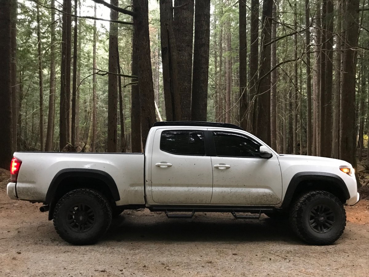

Anyone who has a 2.5- 3” lift and 285/75/16 or 285/70/17’s it’s going to look the same. You won’t be able to tell the .5-1” difference. Basically going to look like this.Thanks.
I'm still trying to figure out this forum. Is there a place where people have posted pictures so that I can see examples?
Anyone who has a 2.5- 3” lift and 285/75/16 or 285/70/17’s it’s going to look the same. You won’t be able to tell the .5-1” difference. Basically going to look like this. View attachment 16638
Thanks.The truck looks great.
You should lift yours so it doesn’t look like a wiener dog.The truck looks great.
