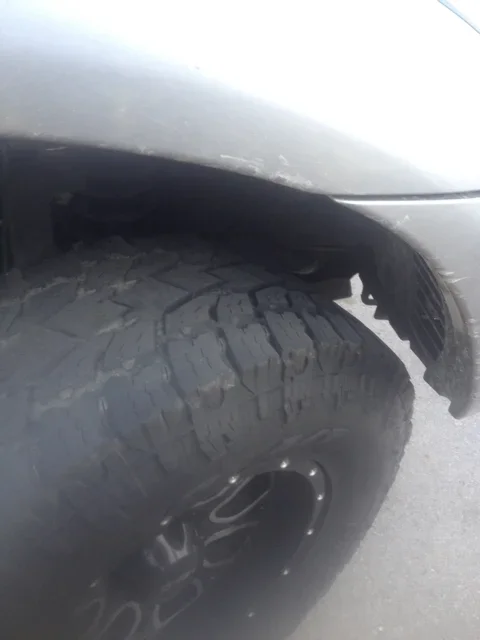

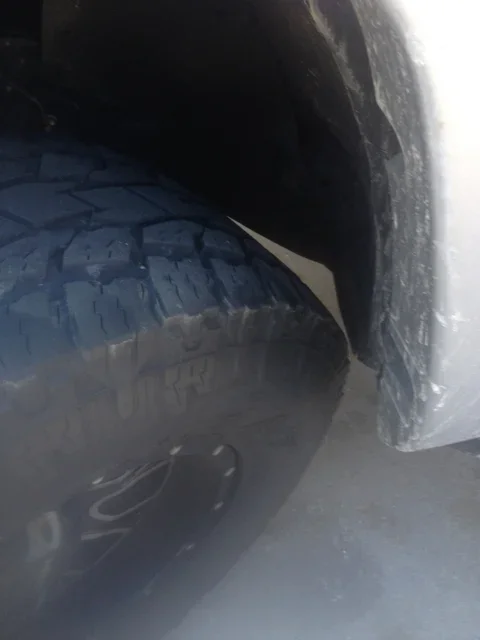

How are we doing everyone. I just bought a 2014 sr5 v6 double cab 5ft bed. It only had one owner with 30k miles who put a 4or 5 inch lift on it, 18"helo rims and 35x12.5 tiers, brush guard, and step rails. One thing I have to say is he did it right. I don't like how my front right tire rubs when maxed out as well when I go over something and the front spring compress. I don't know much terminology so be kind if I ask to explain something haha. Most of my miles are highway and it's not a smith ride. I am most likely goin to sell my 18s for 17s or 16s so that the tire price dosent kill me.
I like the meatiness of the tires but don't like the rubbing. What size could I get to minimize the rubbing and have a smother ride?

You can go with any tire between 265 and 285 with no scrubbing. A lot of guys on here went with the 285/65/17-18. Preferably I went with the 265/75/18 with a negative offset rim. You'll need to make sure the front bumper is trimmed. 33x12.50 look great on the taco but are just too big without new adapters or spacers
If I keep them and get spacers will that stop the rubbing? Also I heard a lot about changing the gears to 4.88 if you have large tires and that it will help with better performance for the transmission. Should I do this? I just don't know if the previous owner did it already but I don't think so because it's having trouble down shifting.
Put up pics and we'll have a better idea! Pics of front suspension up close, turn your steering wheel all the way in one direction. Take a pic of how close the tire is to the back of the wheel well where the body mount is. You might have plenty of room !
